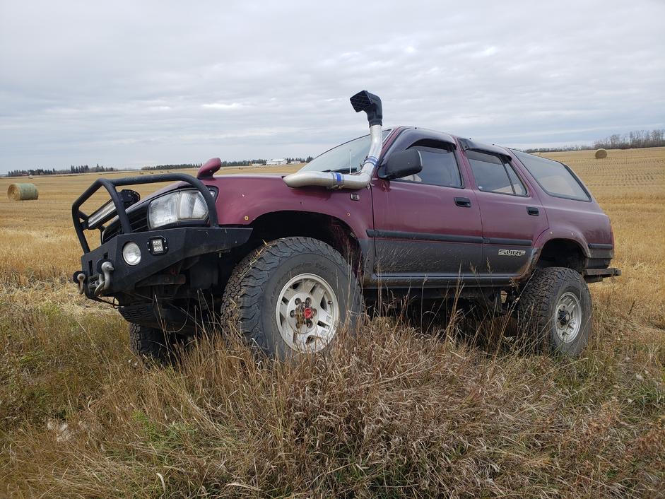

Mine has : new AMC head, amc head studs, all new OEM gaskets, separate tranny cooler, new fan hub, fj80 fan, new water pump, toyota red coolant, high flow turbo and injectors from New Zealand, fuel cut defender, boost controller, custom 3"ss dump pipe and exhaust. Going to go with a top mount intercooler with a fan for offroading as well as water injection. .
It definitely has more go then it used to.
Got any questions let me know

SWEET RIG! What is a "fuel cut defender"? I'm going to do the glow plugs, radiator, and front mount intercooler first chance I get. Seems the intercooler is the biggest preventative measure so I DON'T crack the head...
Thanks for the info
Fuel cut defender stops the boost sensor from seeing boost over about 14 psi. If you up the boost further the ECU goes into safety mode. So now I'm running 18psi. It's not an ideal way to do it, just there until I can afford a manual injection pump. If you do nothing else, I would do the EGT gauge. Made a huge difference in how I drive the truck.
Gotcha. Thanks! I doubt I'll be upgrading the turbo any time soon, but new injectors might be good to have on hand. What are your sources for parts? I', compiling a list so I can quickly find the parts I need for any future repair or upgrades.
