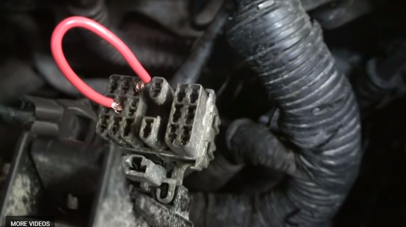

when you say you can't get codes to display did you jumper the terminals to on the diagnostic port on the passenger side wheel well?

Absolutely. Did it many times and the check engine light is on constantly at ignition on with no flashes. Read every article I could find to see if best to install jumper first before ignition on or after. Used paper clips, copper wire for better conductivity, but to no avail. Pulled EFI fuse and tried after that, still no codes and check engine lot on while running. I had never seen the check engine light on after startup until 270k when the fuel dampener had to be replaced and the shop left the EGR valve connector off and only partly bolted back on. Thus, I know it functioned once and was able to get codes. Considering installing the jumper and testing for current across the test connectors.

First, since it doesn't have a crank position sensor, the 3vze engine does not have misfire detection per se - the only CEL code you would get due to a misfire would be some kind of emissions detection (too rich, most likely).
Second, since there are no codes, you might check the CEL wiring between the light itself and the ECU. There is a blue wire between the CEL and pin 5 of the ECU. The ECU lights the CEL by pulling that wire to ground. If that wire is shorted to ground externally, the CEL will light even if the ECU knows nothing about it. You could pull off the ECU connector and then test for continuity of that wire to ground. It should be open, or at least a reasonably high resistance.
