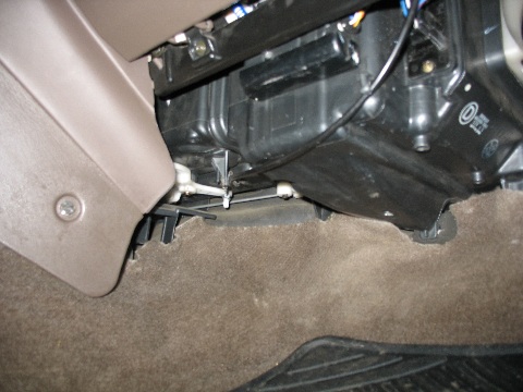

OK Boys. I fixed mine last nite and took pictures. The hot handle has a 2nd push cable that runs under the passenger side of the dashboard to a lever. On mine that cable had been kicked off its retainer and was flexing rather than actuating the lever. It took about 5 minutes to look under the dash while moving the hot handle, identify the loose cable, and push it back into its retainer.
air damper lever
let me see if I can upload this photo...
H'mm, so I'm 2 for 2. :bigok:
