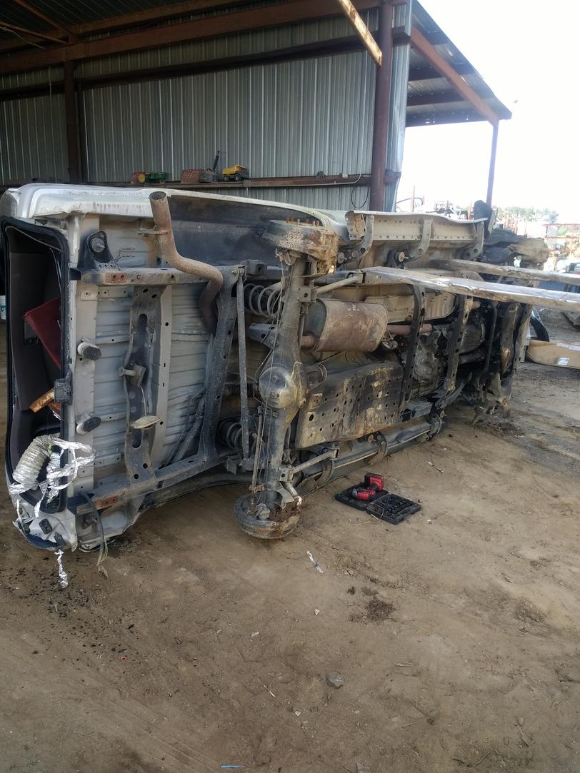

Messed up my gas tank when dropping it for a bit of rust repair, so went hunting for a new one yesterday. Found on I think will work at the semi-local scrap yard.

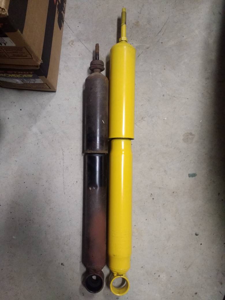

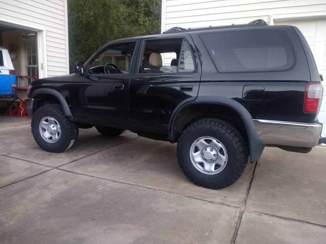

2 inch lift via front spacers on new stock height struts (fat Bob's garage) and 2 inch rear spacer on factory rear springs, FJ80 rear shocks...265/75/16 bfg ATs. Rides pretty good.IMG_20181006_180610761.jpegIMG_20181005_185408361.jpegIMG_20181008_183241574.jpeg

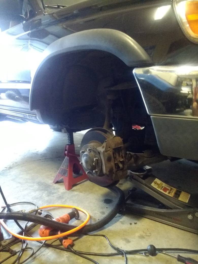

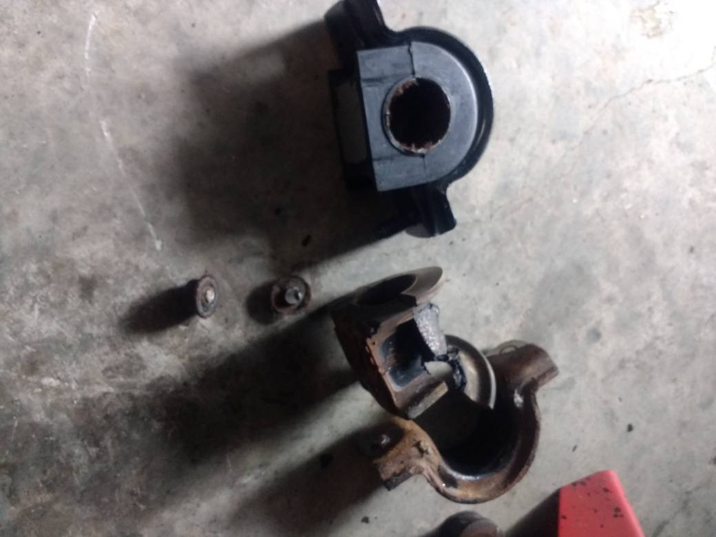

Also replaced my front sway bar bushings...complete with broken bolts. It was time.
