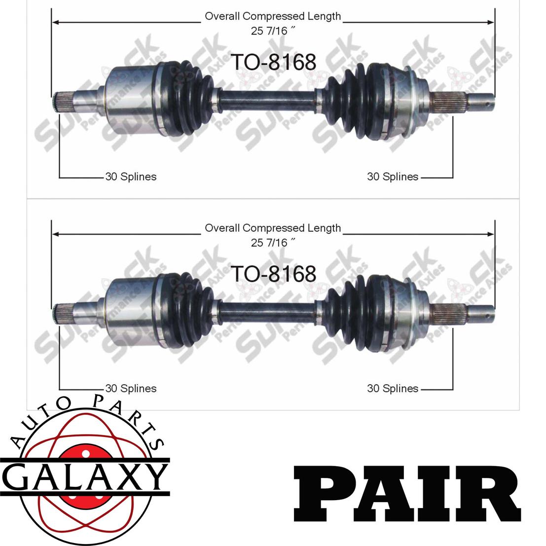

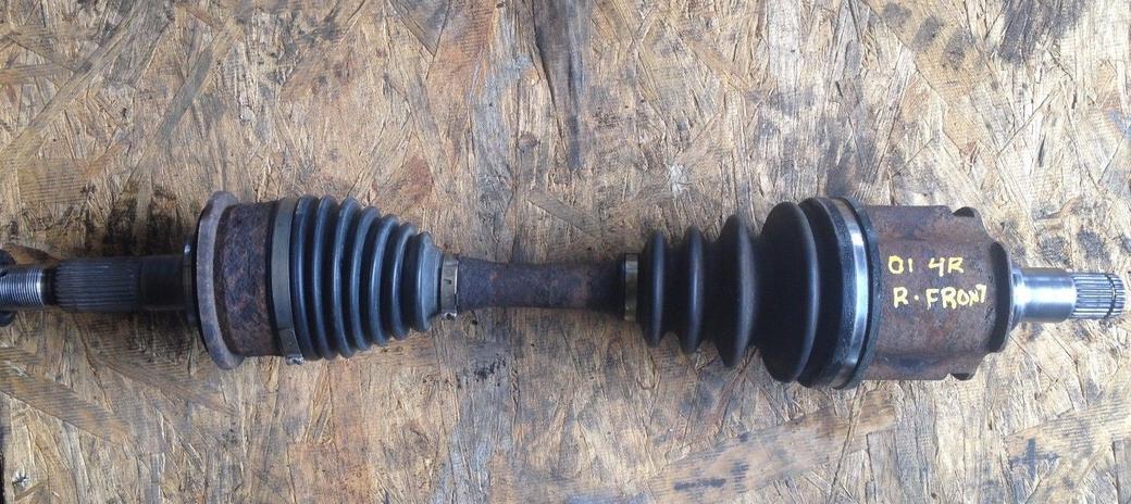

Hi. I was using 4wd on my 97 manual shift 4Runner SR5 and tore a boot on the passenger side CV when the stabilizer link came off and ground in to the boot. I put a new CV axle in and now the dash indicator light doesn't come on when I shift in to 4Hi or 4Lo. I put it up on 4 jack stands and made sure that the front wheels still engage when I put it in to 4Hi or 4Lo. I can tell its in
4wd when I drive it because I can hear it engage and I can tell by the way it feels. I replaced the actuator switch, but the dash light still didn't come back on. I took the console out and checked the bulb. It's working when I switch to something else. The 4wd fuse is good. The ADD switches all have vacuum. Is there a way to follow the wiring up to the 4wd indicator light? This may be a dumb question, but could the new drive shaft be causing the dash light not to come on? It is different looking from the old one. I've attached pictures from the web showing their differences. Thanks for any help anyone can give me with this.
