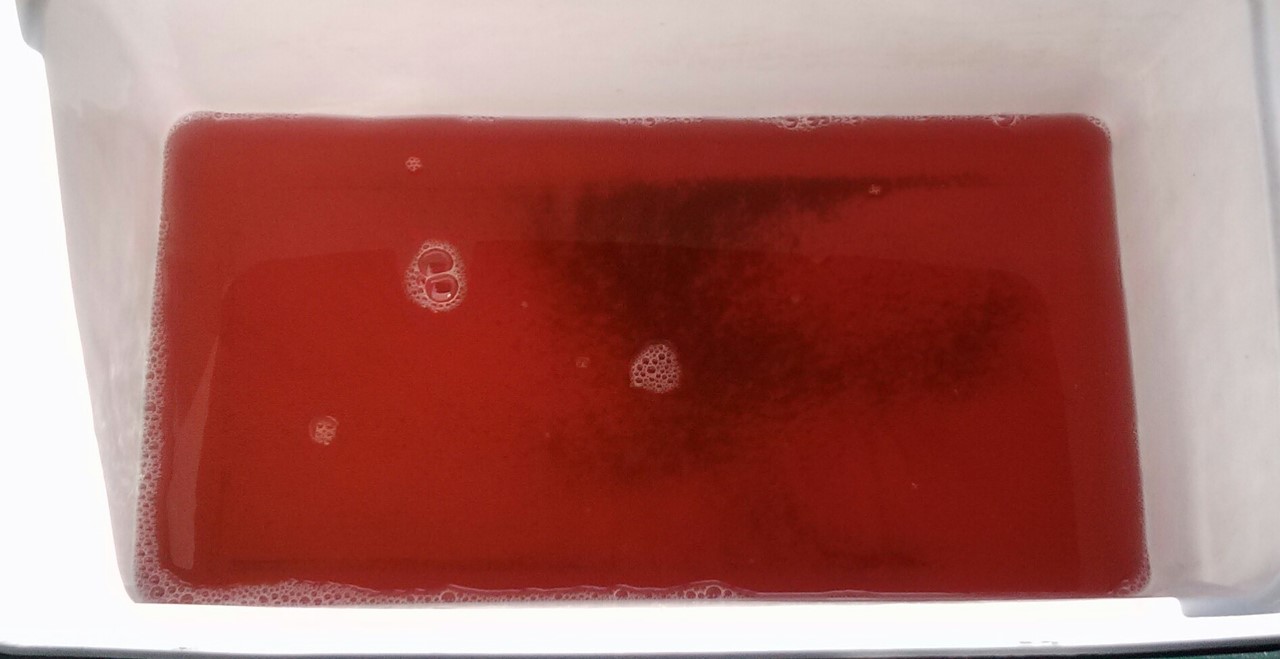

It is finally above freezing here today it was 55 degrees, I froze my ass off carrying the mail last week, 7 below zero Saturday morning. My heat was doing the same thing, warm for a little while, would cool off if the fan was on for long periods of time. I decided that I would back flush the heater hoses going into the back of the block, I know I would waste the fresh coolant but I did not care. I do not understand how this much rust could still be in my coolant system but it is still there. I am going to do another super flush tomorrow, supposed to get below freezing again this weekend. But my coolant system is still full of rust.

I ended up selling this vehicle to a buddy if mine, full disclosure of the issue of course. I think that the someone who had owned this 4runner in the past treated it like crap, because I did end up going crazy with flushing and some nasty nasty things came out. I do not think this issue could have been resolved without replacing the heater core.
