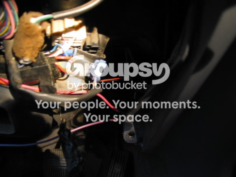

I've got to get to a trail work day so for now I did this to my 96 SR5:
and buttoned it back up. Four bolts for the panel under the steering column, 1 blue connector unplugging below the ignition switch. No more door buzzer. Still have the headlight on warning. Unfortunately no auto-unlock when you leave the keys in so I am going to dig further when I have a chance.
On the 96 the buzzer is by the fuse block, though I didn't want to disable that. I am not adverse to cutting wires though, but need to find a wiring schematic to see if that's an option that will allow for only the door buzzer to be disabled.
