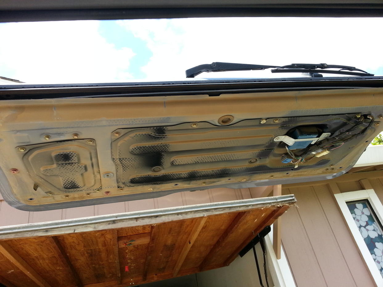

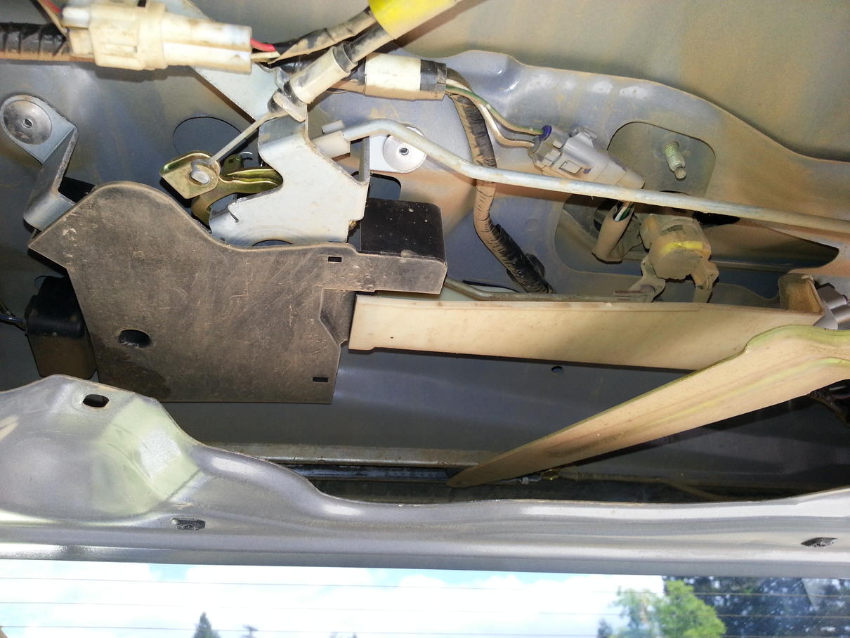

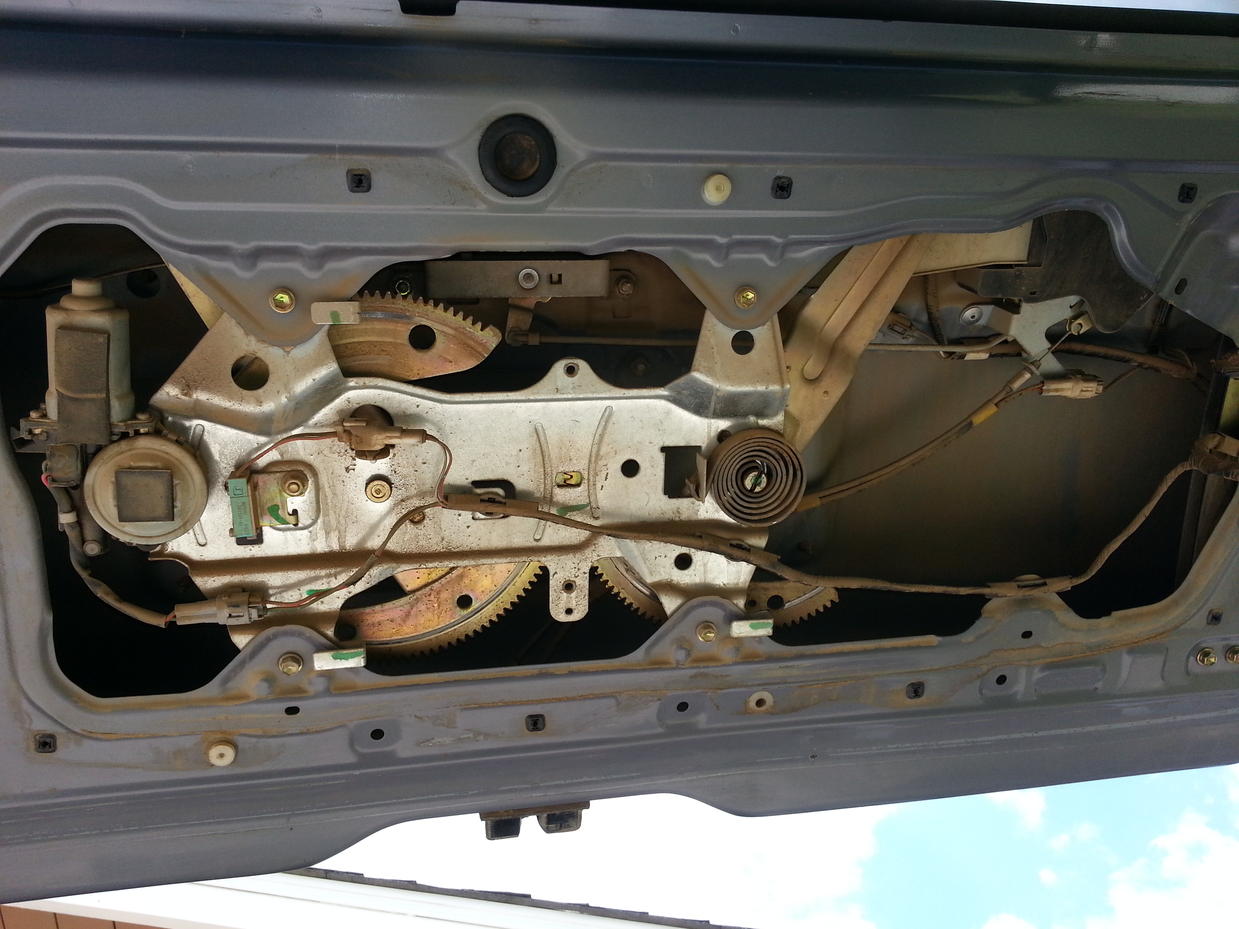

It could just be gunked up too. I had this happen and it's an easy fix. Just pop the panel and hit everything with some cleaner followed by WD-40. Here are a few photos I took for another member who had an issue with their lock. Remove the platic panel and there are a few metal panels to take off. After this you'll have unfettered access to the mech in the hatch.

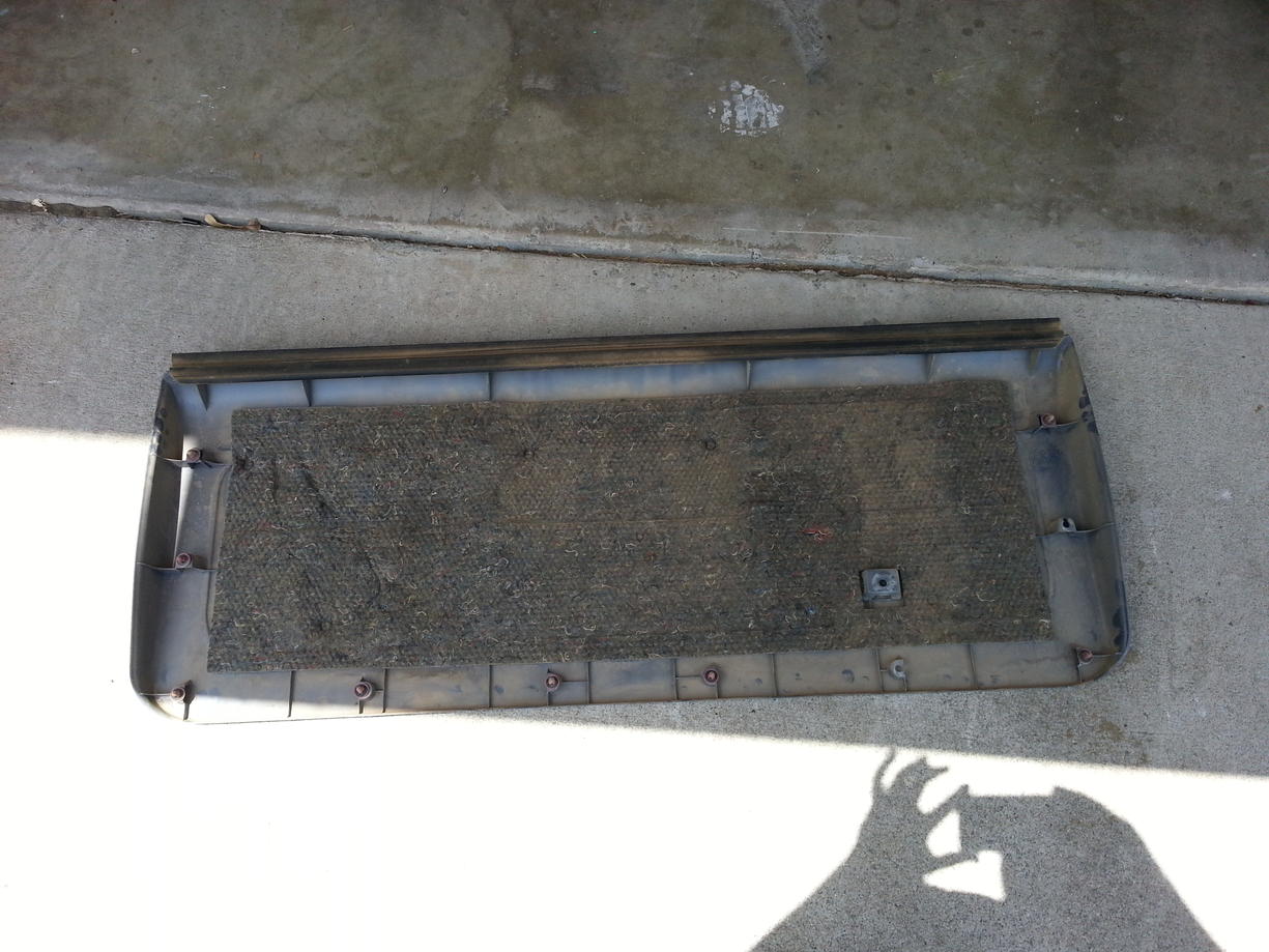

I'd start with a large flat head screw driver with some duct tape on the end. This will keep you from scratching your panels or paint. I started prying at the bottom and as you pop the platic rivets loose you can see where the others are. Just work your way around and you may have to use more muscle than you'd think. Here's the inside of the panel for reference.
Edit!
Very Important! You will need to remove a bolt that is next to that nylon strap. I just remembered after looking at this picture.

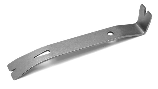

A thin prybar with a 90 degree end works well for removing the panel with the door closed. something like this:
As others have said, start by removing the small plastic cover by the pull strap and then remove the bolt behind that.
Next, move to the lower corners and free them. Work towards the center, and then up each side. Hook the prybar behind the panel and pull towards yourself.
Once you're that far, lower the rear window and then lift upwards to remove the panel.

Once you have the panel off you should be able to see the rear door handle. Follow the rods to the driver's side. There's your latch. Actuate the latch by pushing the rod towards the latch (I think. If that doesn't work try the other direction)

Now comes the part where you have to figure out what's wrong. That's on you. If you need to get the door handle off You'll need to unbolt the window regulator (4 bolts) and then you can move the entire regulator/window assembly around to get clearance to the various attachments. The handle comes off with the bezel if you have to go that far, but you probably wont.
If you remove the rod from the handle, pay attention to which direction the bracket goes. it will bolt on in either direction, but will only work in one.
Once you get it sorted out, then re-install the window regulator. This is where you thank yourself for leaving the window down a crack as it will be much easier to position the regulator in line with the bolt holes.

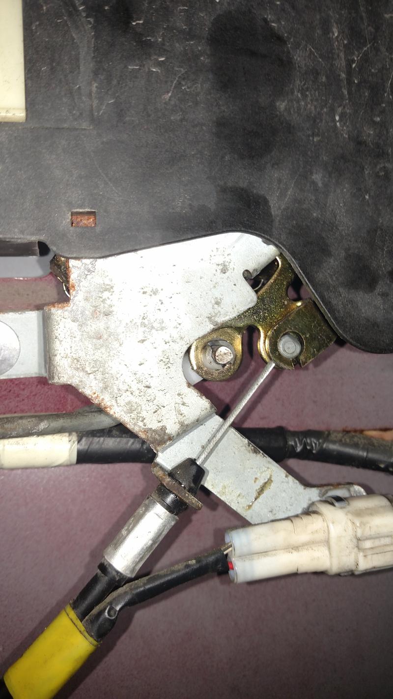

Followed this link, took everything off expecting to have to grease me lock. Found that the rod/linkage from the handle is not pushing the linkage to pull the lock open. I can manually turn and open the lock. Not sure if there is a part missing in the rod from that handle or what to purchase to replace.
Any help would be appreciated.

I'm having the same issue, the rod slides to the drivers size, but the wire down the latch does not move.

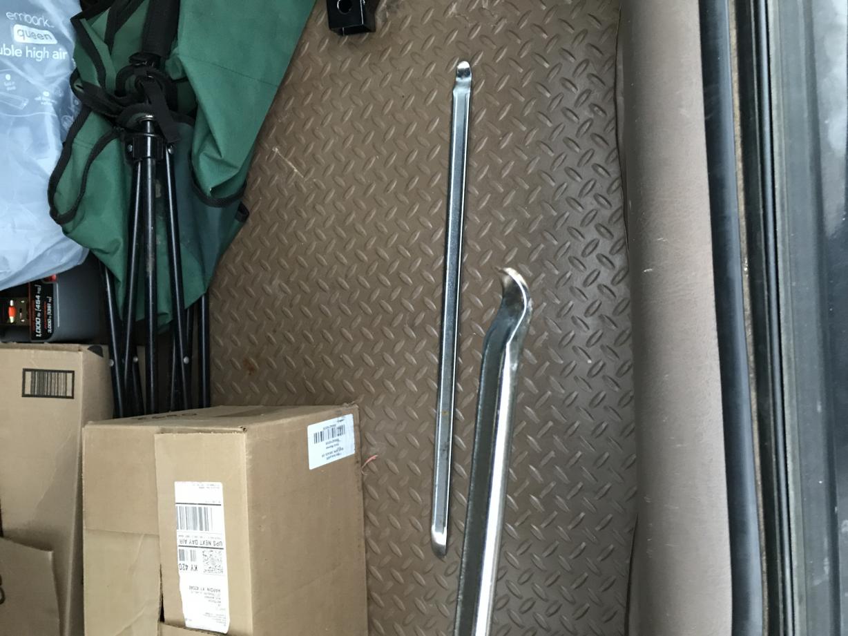

I didn’t have much at my disposal to try and help remove the panel. First thing I grabbed ended up working perfectly. Takes the panel off super quick and easy with no scuffing nothing. Like incredibly easily, strongly recommend using a tire iron and the curved end of ya got one. For the initial removing of the snaps. My problem was similar, the door had been stuck in the not fully closed position since I bought it. The linkage wire(not sure proper term) running to the latch part that secured the back door shut had broken off. So the wire was just hanging and not connected to the little metal cylinder. Was much easier to just remove it and flip it , placing the still intact end towards the bottom , where access was much more difficult, and wire up the uppermost connection point with some wire. Works great now. Also I had an issue still with the door shutting completely. Had to slam the fire out of it to get it to shut completely. Used some penetrating oil and found that some small bit of plastic-like gasket material had broken down a bit and was coming apart causing much friction. Pulled out a little bit of it and soaked with the oil. Still takes a bit more elbow grease to shut it than is ideal, but it works. Didn’t have to hunt any replacement parts so that’s great. Wonderful thread , thanks y’all !

When rear hatch is locked, the linkage rod does not engage the cable
If the linkage rod doesn’t move/engage the cable to open the hatch, the lock mechanism is most likely closed. There is a second rod that links the lock to the locking mechanism. It is above (but not visible) the linkage rod and cable, behind a piece of plastic. Find that and lube both ends. There is also a lever that locks/unlocks the door above and to the left of the cable end. (also hidden, find it with your fingers.) Find that and you can manually lock/unlock the back hatch.
When the lock is in the locked position, the linkage rod will not engage the cable to open the door. When unlocked it will engage. I found the locking rod was gummed up where it connects to the lock. Silicone spray solved the problem and everything works now.
