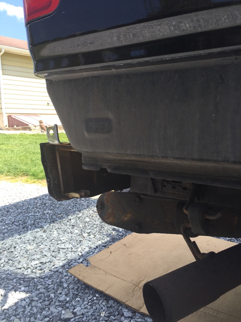

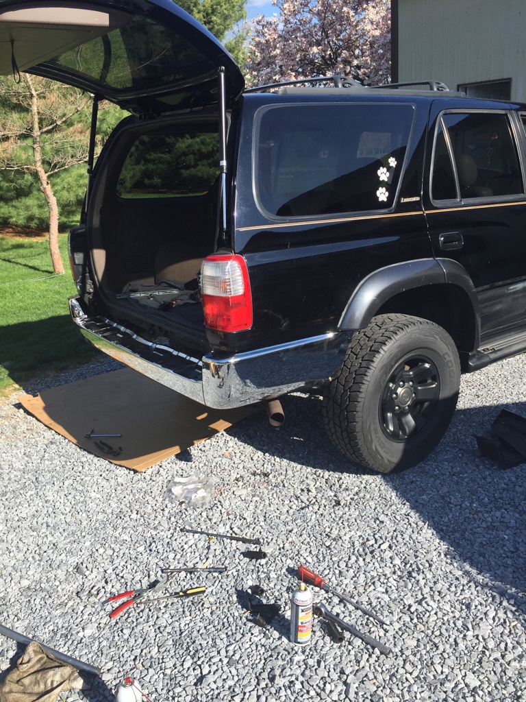

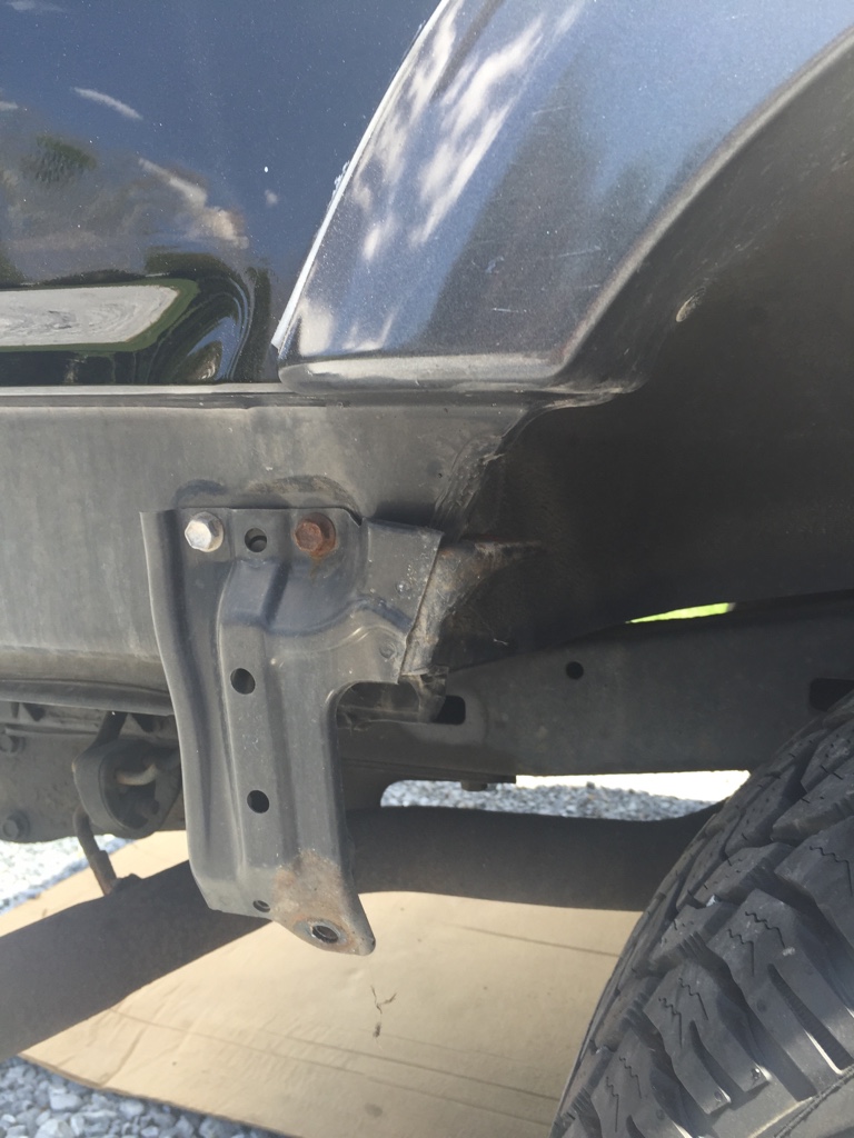

Here other side the same
Edit. And finished
