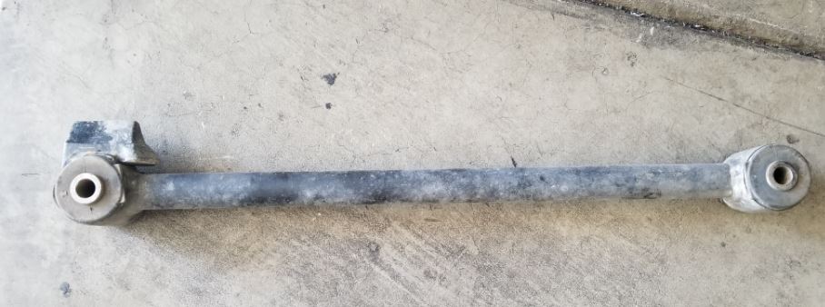

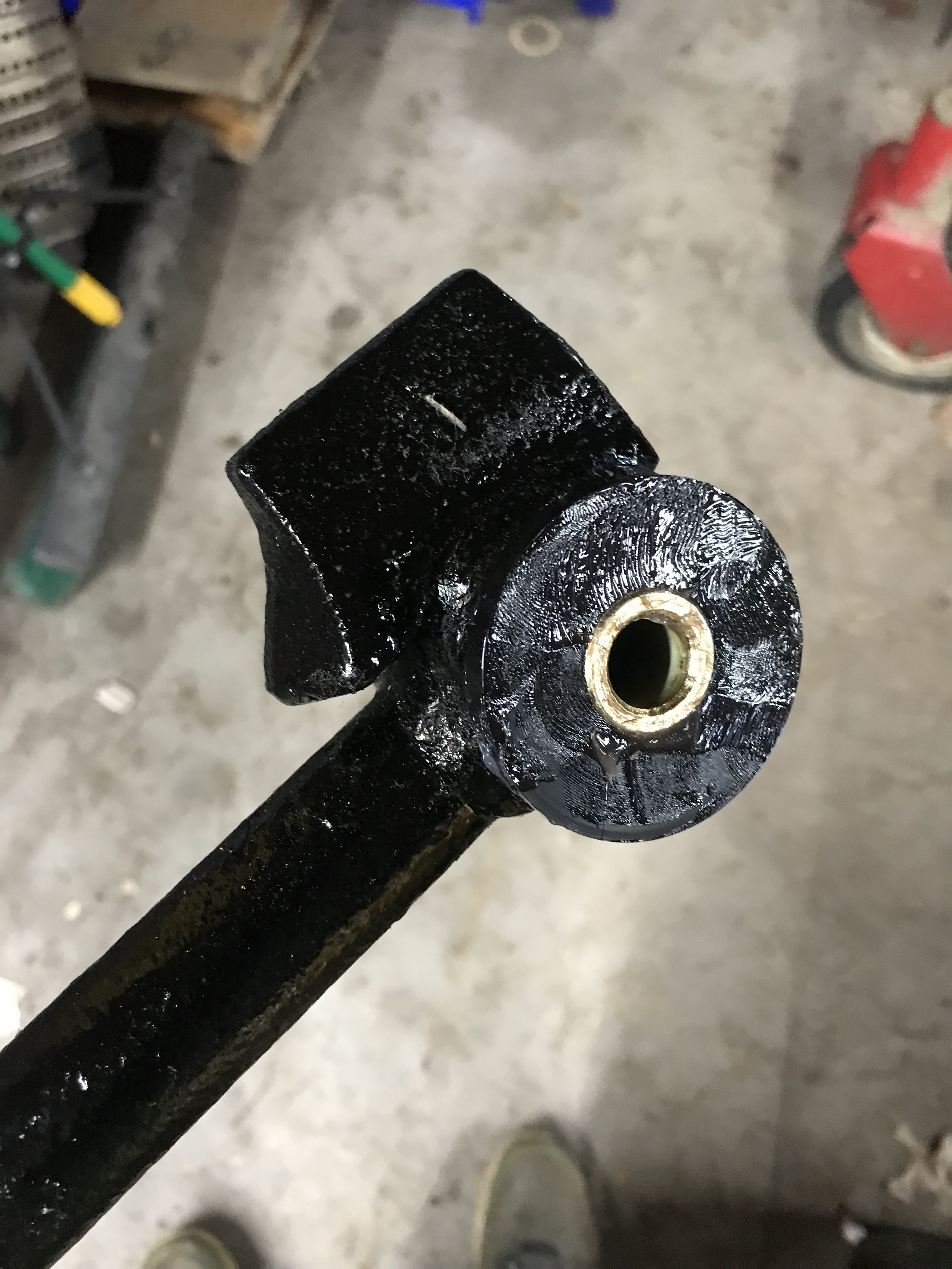

Has anyone ever seen an LCA like this one? This is the side that attaches to the frame
What is the purpose of this extra metal wedge welded on to it
That control arms looks unique. I havnt see one that looks like that before. I just recently changed all upper and lower rears on my 96, 2 weeks ago. It had original bushings on, and my truck has 300k mi. I definitely noticed a big improvement, especially going over imperfections in the road.
I very well could be wrong on this. Maybe there was a redesign? The picture I posted was off of a 99, and I know they did some redesigns on that year.
Aw, I see. Maybe the picture of the ones I posted are of the opposite side of the bushing of what [MENTION=94914]turbo8[/MENTION] posted? I can't quite remember, but can look tonight. Still doesn't answer the question of what that bump is. Was the side with the "mystery hump" located on the frame or on the axle?
The opposite side looked the same, captive rubber bushing.
I believe there was a redesign, I would like to know what the hump is for too.
It is a solid piece welded on to the the end that attaches to the frame, the hump faces towards the ground and sorta tucked into the lower mount area.
Maybe to crush rocks or keep rocks out of the lower mount area. Some sort of vibration reducer?
Also it was facing upwards on mine, and I’m pretty certain it was never removed, I bought it from the tweaker daughter of the original owner and neither of them did any maintenance or repairs over the life of the vehicle as far as I can tell
Both my 97 and the 97 limited I pulled the locker axle out of had that steel wedge. The later models I have seen do not. I think it was only on the 96- 97
