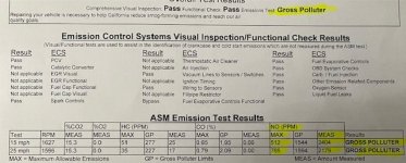

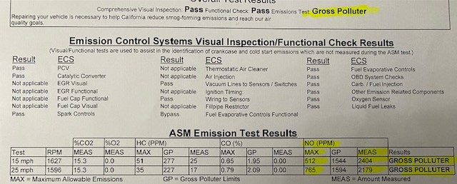

I know I am reviving an old thread here but my '98 just failed smog with VERY high NO numbers. I am curious if the steps Reina initially took will be enough or if I have a bigger problem somewhere.

I could not seem to find anyone else that discussed having such high numbers with no other real issues so I am hoping y'all can provide a little more insight.
For some background on the car, its a '98 SR5 3.4L 2wd with 240K miles on it. The oil was changed recently and the plugs were changed at 233K and look pretty good based on my knowledge. (I did switch to single ground NGK G-Power Platinum after reading that it may only matter for longevity, correct me if I am wrong here) The Cat was replaced at 220K miles almost 4 years ago to the day. Other than that the car runs great, a few issues here and there but not anything I think would be relevant to smog issues. It has not thrown any codes and does not appear to be smoking at all besides right when starting up in the mornings.
Thanks for the help in advance.
