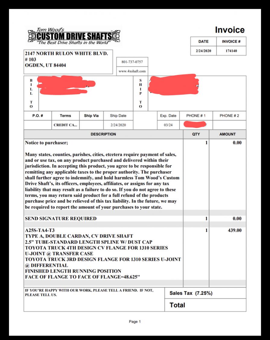

Thanks for the info. I mostly drive pavement (ok, so, I always drive pavement thanks to 80 hr work weeks, lol) so I got the .083. Triple-measured the flange patterns. They came out to 60x60 at the differential and 66x66 at the transfer case. Flange to flange length was 48.5". With tax, it was just a hair under $550.
I'm sure I could have spent an afternoon w/ busted knuckles and swapped out the rear Ujoint, but that double cardan has 350K miles on it so it was probably contributing to the rattle as well.

The u-joint on my driveshaft wore out and I was getting the clunk while stopping/accelerating and a lot of vibration at 35-65mph.
I replaced it with a Tom Woods shaft and been running it for around 4 years with absolutely zero issues. I grease all of the zerk fittings at every oil change and it's smooth as butter.
It took me about an hour to install, it would have been quicker but rusty/seized bolts slowed the install.
I highly recommend a Tom Woods Shaft.
