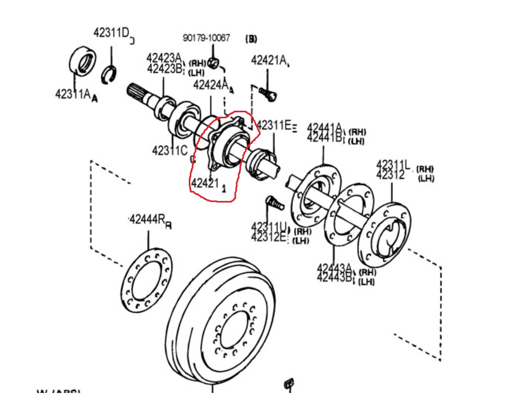

It sounds like the actual axle housing where the bearing outer race sits is worn, egged….

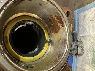

I've tried two different housings the first one i tried to put a small shim in with no luck but maybe. They are crazy expensive from the dealership for a new one. I'm aware the bearing doesn't sit here. Only photo I got from the last job I did.

so you even tried with a junkyard complete unit and had the same issue. How does it compare to the other side ?
Sounds like an egged out bearing cup.

If you have a spare bearing you can slide it into the housings hole to see if there is any play, like to check if it's out of round. Or check it with a bore gauge or dial caliper.
Sliding a new bearing into the axle housing hole and looking for the play between the OD of the bearing and the housing would tell the story.

But I thought the bearing does not sit in there? Like it just sits in the housing and and on the axle and the ABS ring just spins in that space?
Holy smokes, I need to be more careful posting stuff when I'm beat tired. Sorry you are correct, the abs tone ring resides in the void. I'll go back and correct my post so if anyone comes across it they won't be confused.
The bearing sits only in the cup. So either the cup is the issue, or there is an issue with the retainers and abs tone ring or the c clip isn't seated or an out of spec bearing.
