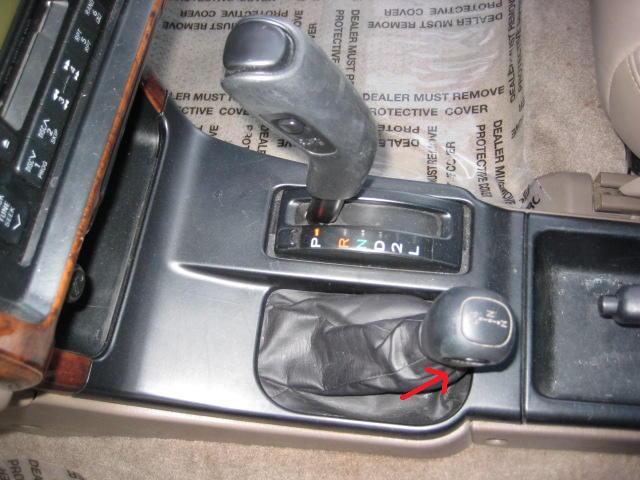

Alright does this photo mean that this runner is an AWD with only 4H and 4L. Sorry to keep harping on this issue just trying to learn all I can from the guys that drive them all the time. Photo is of a 98 limited. I didn't see this thread and I started one under the topic of Newby needs help. Thanks

Alright may have answered my own question. Does the button on the side of the gear shift engage the 4x4 in 4H and also disengage back to 2H.

I'll bite.
What you have is on-demand 4 wheel drive.
Under normal driving, you use standard rear wheel drive (2wd)
In snow/rain, you can select 4hi (push button) on 2nd shifter. This gives you 4 wheel drive. You can drive on dry pavement in this mode. [****EDIT - You should not drive on dry pavement on the version you posted while in 4h*****]
In really really poor conditions, stop, shift into neutral, move 2nd shifter down.
If stuck, while in neutral, move 2nd shifter over to 4 LO.
AWD means all wheels are driving, all the time with the computer transfering more power to the front when wheel slip is encountered.
The only 4Runner that is AWD is the V8 version of the late model truck.
The upside to AWD is no worries, just drive.
Downside is it is not true 4-WD. There is no lower gear options. You can get stuck and not be able to get out. Regular gas mileage is much lower. I speak having a Passat AWD vehicle. Getting stuck is not hard.

You're correct up until the shift procedures. You can go from H2-H4 to H4L (by moving the lever down) at speeds below 62MPH (same goes for going from H2-H4 by pressing the button on the side). You only have to stop and put it into neutral when going from H4 to L4.

The 4WD systems in the V6 or the V8 are virtually the same. They are both open-center diff systems. And yes, there is a 4L in the V8

Yes, when you push the lever down (it's a J-shift lever) to H4L, it locks the center diff (that's what the L stands for - Lock). There is no off-road disadvantages with this set up. Actually, you get the best of both worlds -- Ability to run AWD on pavement and 4WD off-road. I wish my Tacoma had that.

From L4 to H4, stop, put the transmission in N.

Okay, guys, will you stop spreading bad info and read your manual? In a 99 or any 3rd Gen 4Runner, you can be below 62MPH and still shift to 4HI(or H4L on 99-00 Limiteds) on the fly. To shift to 4LO, you have to stop.
