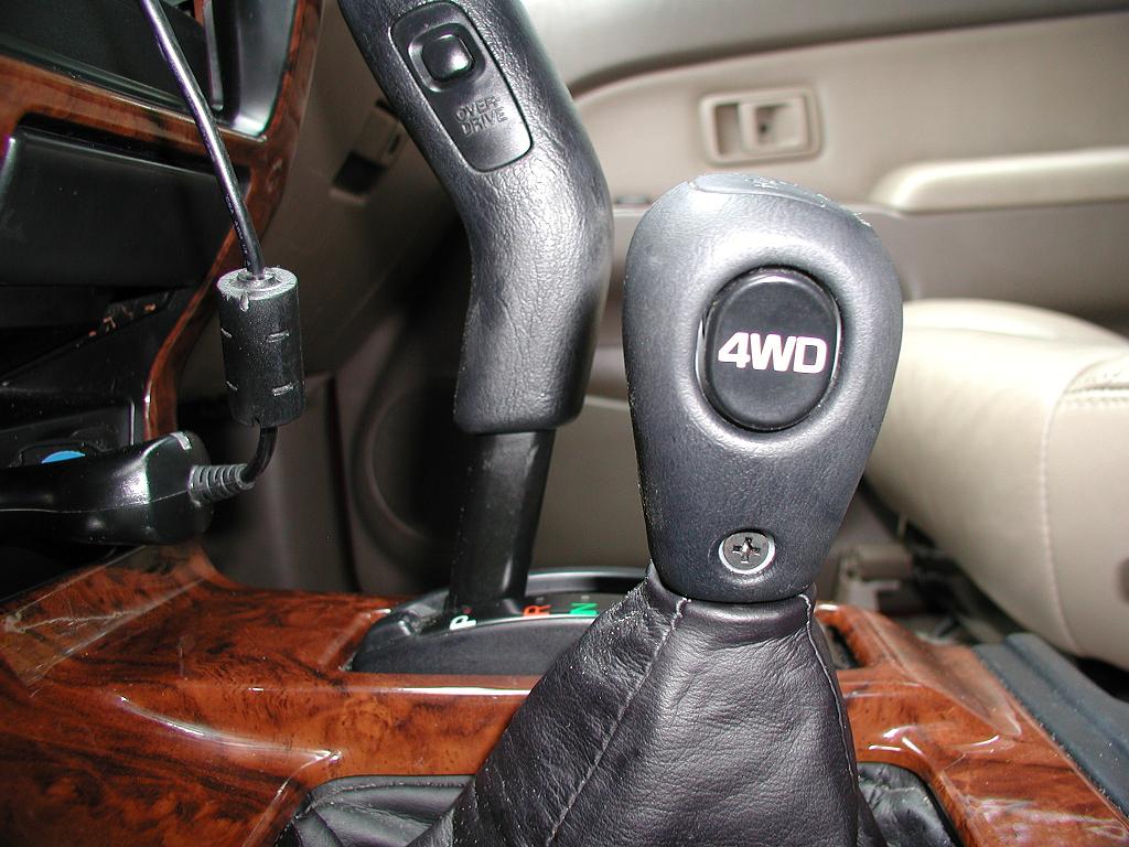

I don't know if your questions been totally answered or not but I figured I would share my info on the topic... I love the 4wd unlocked feature, I use it all the time when in any sort of rain or snow. I have a real tough time going up steep hills in 2wd when the road is wet but all I gotta do is just hit the little button... Here's a picture...

So basically when I push in the 4WD button on my Limited, I'm really switching from 2WD to AWD? There should be some better clarification from Toyota on this issue (like a sticker/ card in the interior stating it ["it" being the fact that you only get true 4WD when you lock the center differential])
But I guess Toyota figured that this information wouldn't really matter one way or another to the majority of people who do purchased their 4Runners. Which is confusing, given the capabilities of all 4Runners

I see you drive a 2002 Limited. From my experiences driving my friends 2002 4Runner, when you press the button, you go from 2HI to AWD (power to all 4 wheels, center unlocked). You should have a button on your dash beside the dashlight dimmer that is the center differential lock. When you press this you go from AWD to 4HI (center locked). There is no rear locking differential on 2001-2002 models, but instead, Toyota offered ATRAC.
Yeah, that is what I figured. The button on the side of my transfer case lever should say AWD then, and not 4WD is what I'm saying. IMO, ATRAC really hampers my 2002's capabilities offroad. For on road applications, it seems to work relatively well.
