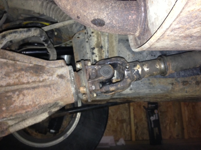

My pinion angle I found between the rear driveshaft and the differential flange to be appx. 2.5 to 3 deg. and between my driveshaft and my transfer case flange to be 7.5-8 deg. I adjusted my coilcovers quite a bit before I got my alignment after my lift. Maybe I didn't lower them enough?
I would not hesitate ordering up a set of toytec adjustable rear UCAs to correct my pinion angle if I can get some definite confirmation. The reason I am hesitant is the fact that for the first 6,000 miles after my lift install I didn't have any noticeable vibrations and after I replaced the rear u-joint the vibrations did not subside. hmmm what to do next...

^^^ yes! If you want someone with more experience in the matter, aka people who have installed the rear arms, PM dirtco and bigfishallday. I'm sure they can point you in the right direction.

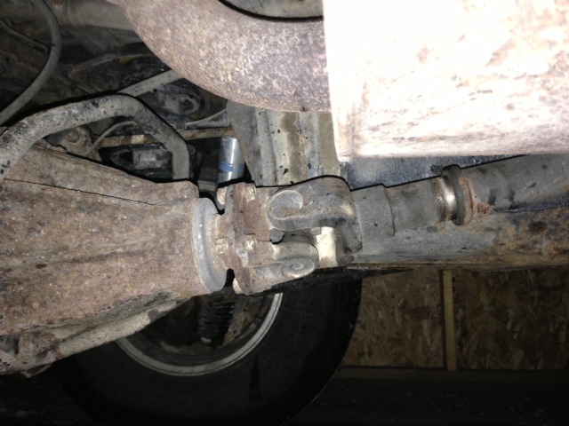

UPDATE: Well we'll start off with the good news.. I recieved my toytec adjustable rear upper control arms and installed them last night. My pinion angle is now dialed in at 0.
Now for the bad news. Test drive proved nothing has changed... My pinion angle and my rear u-joint are happy but acceleration vibrations are still there. Double cardan joint shot? Front drive shaft u-joints bad? Transfer case or differential issue? I'm ready to give up and send it to another shop or the stealership<-(Last resort, but mabye my best bet.) Whatcha all think?

Could be your rear pinion bearing and I doubt it's your front driveshaft as it won't be turning in 2wd. When I put in my first lift (Revtek) I had the trim packer spacer in and that caused a noticeable vibration. CV's were angled too much even with the diff drop. I took the spacers out and no more vibration.
