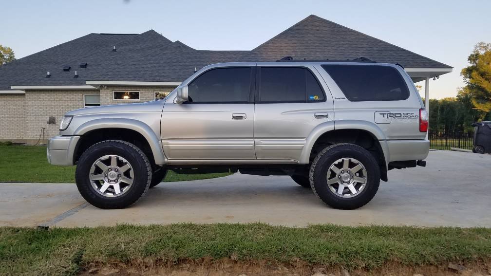

I've got 99 tall springs on mine, I would also add the bilstein rear 5100 shocks to get that smooth ride and also be able to do trails.
I have the Moog 99 spec springs on my 2001 Limited 4wd along with T4r 5100s. Ride is great and extra lift in rear.
