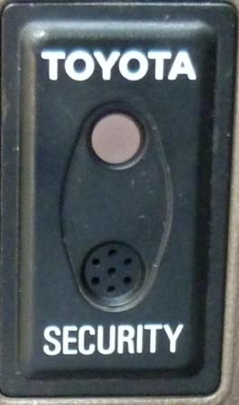

Here is the factory alarm display:

Thanks for the link! However I don't see any black box under my driver seat, but I do have the factory alarm display (the picture you posted) in my dash. What are the steps to trigger the alarm or test to see if there even is one.
I'm starting to think that the factory alarm display and the VIP stickers on the windows are just for show?
