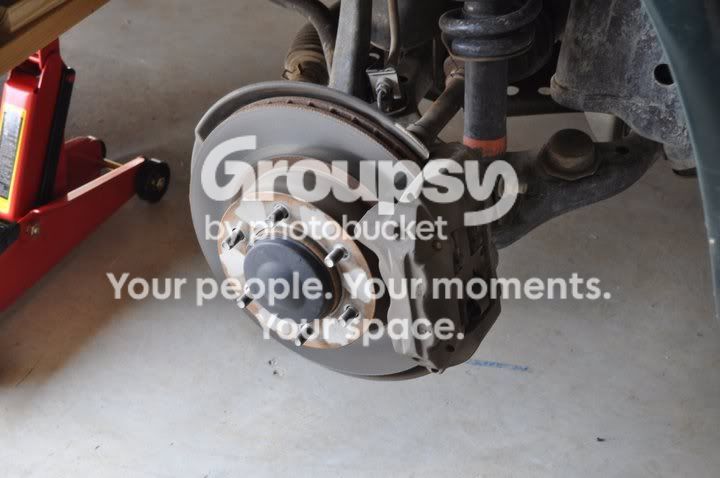

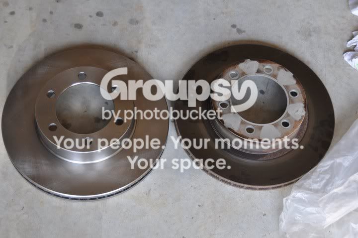

First the title is for those who were not sure that the 199mm will fit. I could not find anybody that had done this upgrade and done not modifications. So this is some of the pictures i took while doing the 199mm brake upgrade. I went with the 199mm because i didn't want to do any modifications to the stock rims or have to wheel spacers.
This is my buddy whose arm I twisted to help me.
pic1.jpg~original

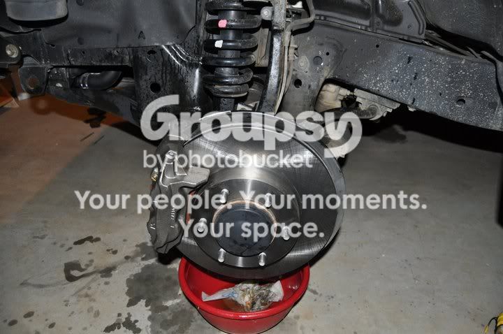

Old crappy calipers and rotors

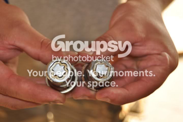

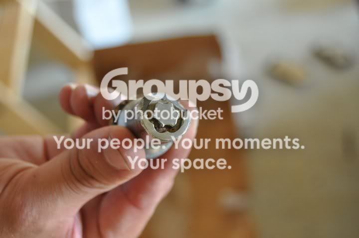

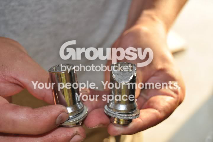

This is what happens when somebody over tightens keyed lug nuts....

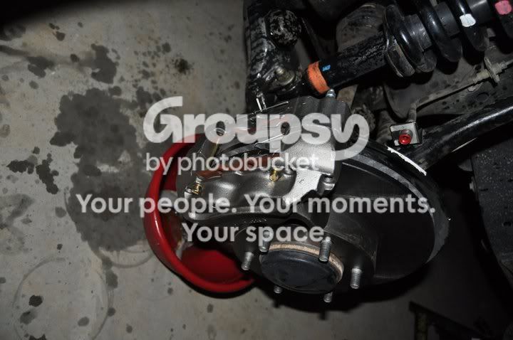

NEW AND SHINY!!!

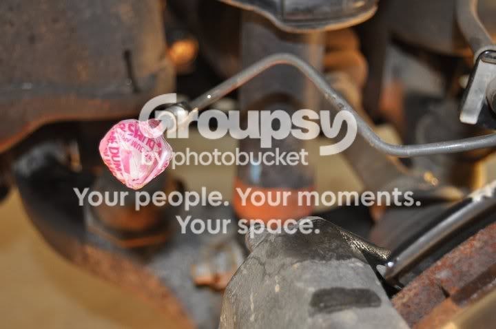

How we plug brake lines in Shannon Hills!

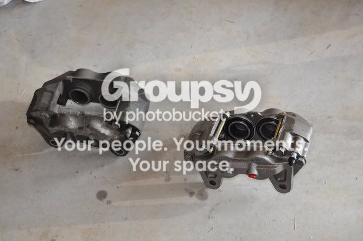

To be honest, I don't know. On my sales receipt they don't state the brand but I bought them from an auto parts store in town ("Automotive Supply Center").
If I remember I'll try calling them and ask for the brand but for now here's a pic if that helps any...

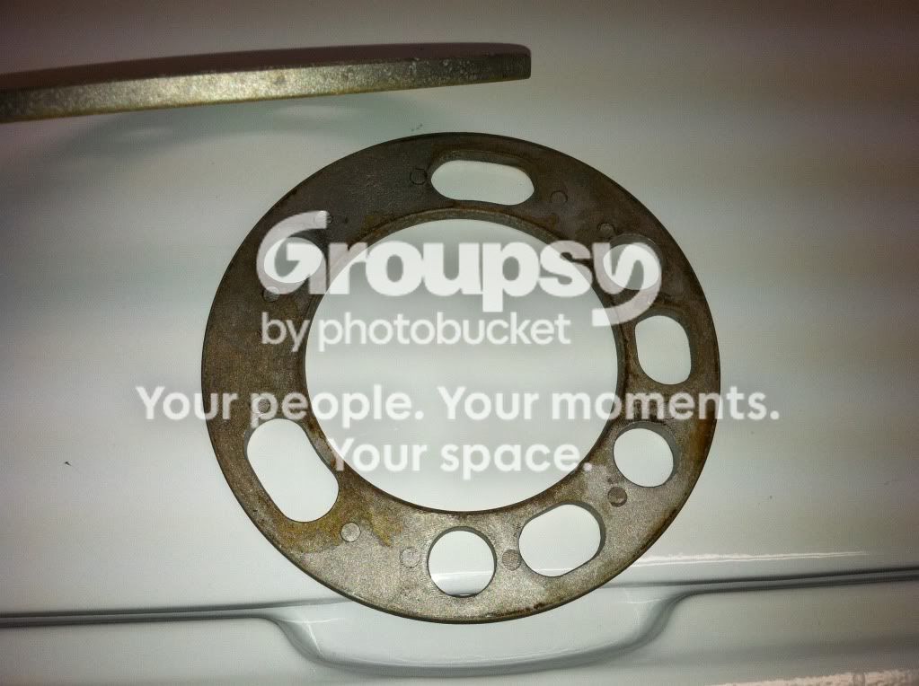

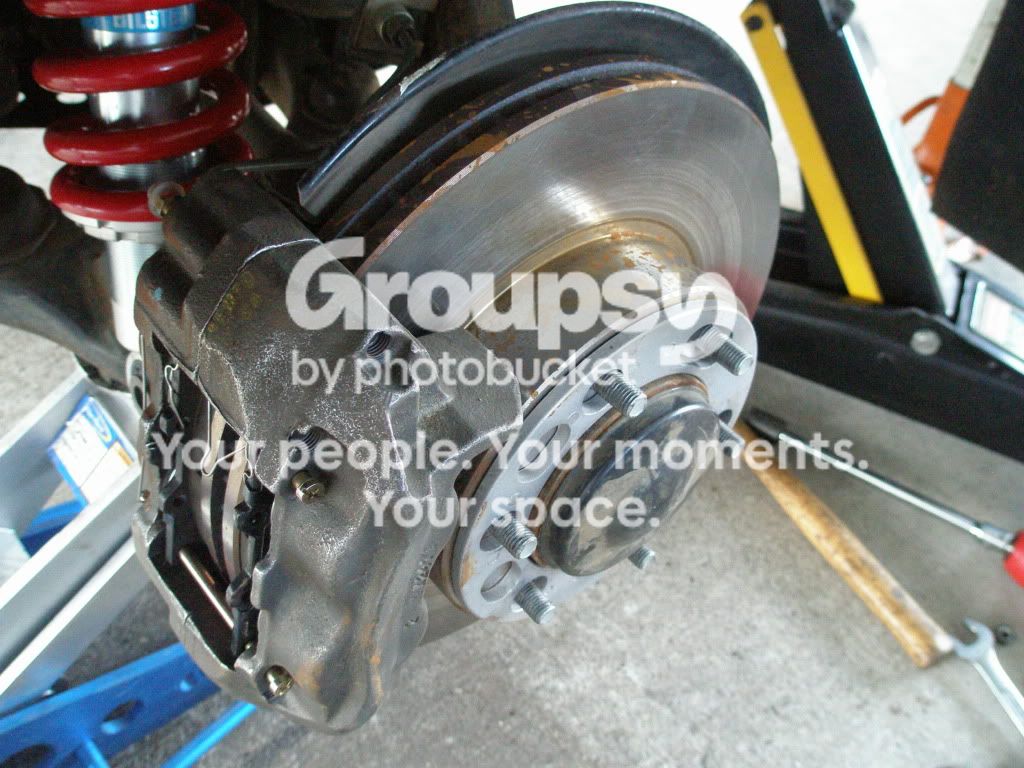

And for anyone who is interested here is a pic of the 1/4'' wheel spacers that I had to use to clear the split 3 spoke rims..
IMG_2475.jpg~original
I wouldn't recommend using a spacer like this long-term though. It caused a lot of front end vibrations and the steering wheel pulled to the left with these things on. For me they were a temporary fix until I got my 5 star rims, which easily clear these calipers.
I wonder if the reason you had to use the spacer was because of the difference in year model between yours and mine......something to think about
