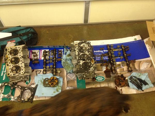

Just replaced my head gasket this weekend. 2004 with 208,500 miles on it. Never overheated and no leaks in the cooling system or low coolant. I got a misfire on cylinder #6 CEL after starting the engine,right as I started it up it had a rough idle. Never overheated the temp gauge never moved. The head gasket I replaced was a different design than the new ones I bought from Toyota. Had the heads and block checked and neither were warped at all. Valve seats are all solid,No leaks,not burning any oil or anything else that would concern you. If the new head gasket design has fixed the issue,I would expect at least 200-300k more out of this engine.

My buddy helped me do it. He is a mechanic and we started at 11am on saturday and finished at 11pm on sunday. I paid for all of his food and gave him a little cash.
He said he's done one before at his shop and it was a little over 2k in labor.It's not that hard if you have the tools and know how to re-time the engine. It's just time consuming,everything is easy to get to and take apart. I'll post pics of some of the teardown.
