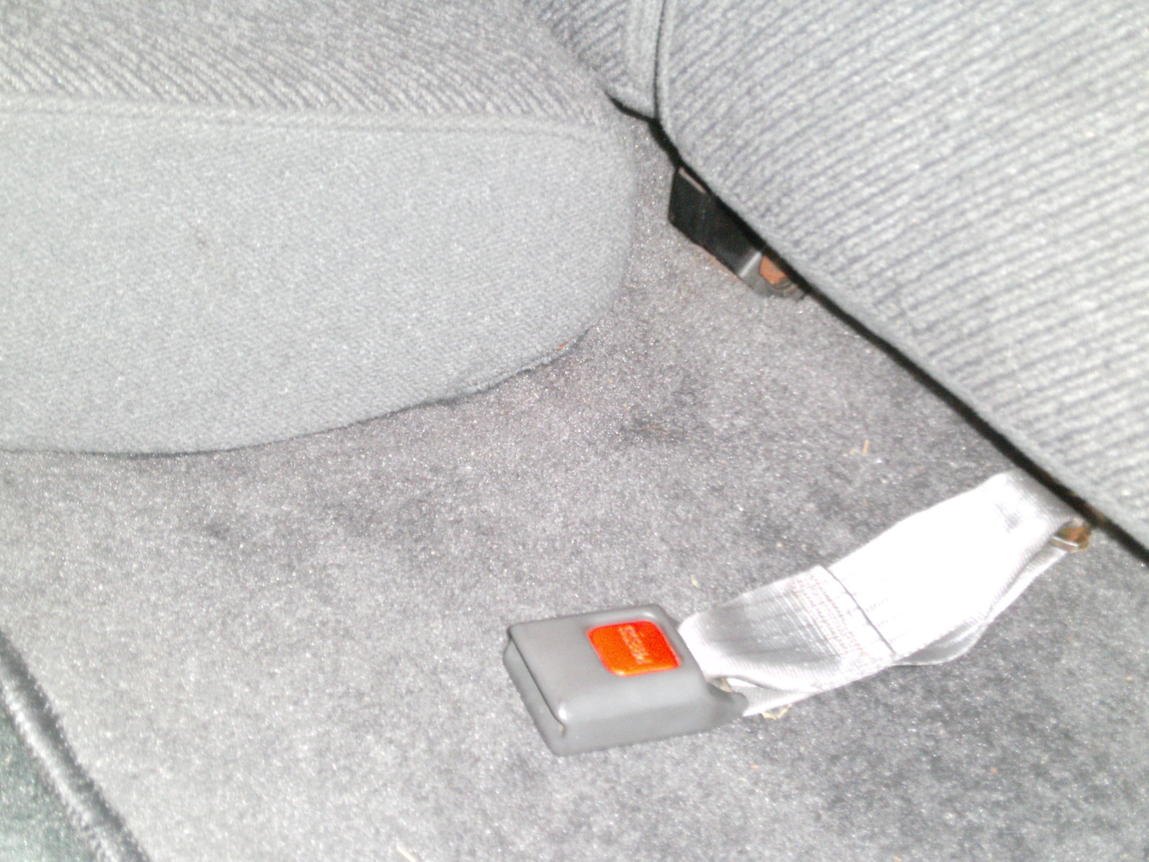

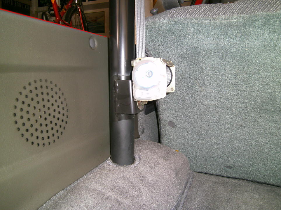

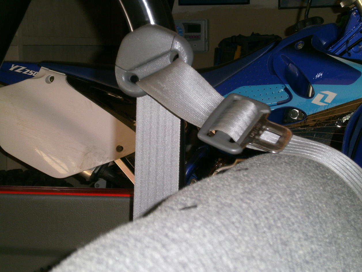

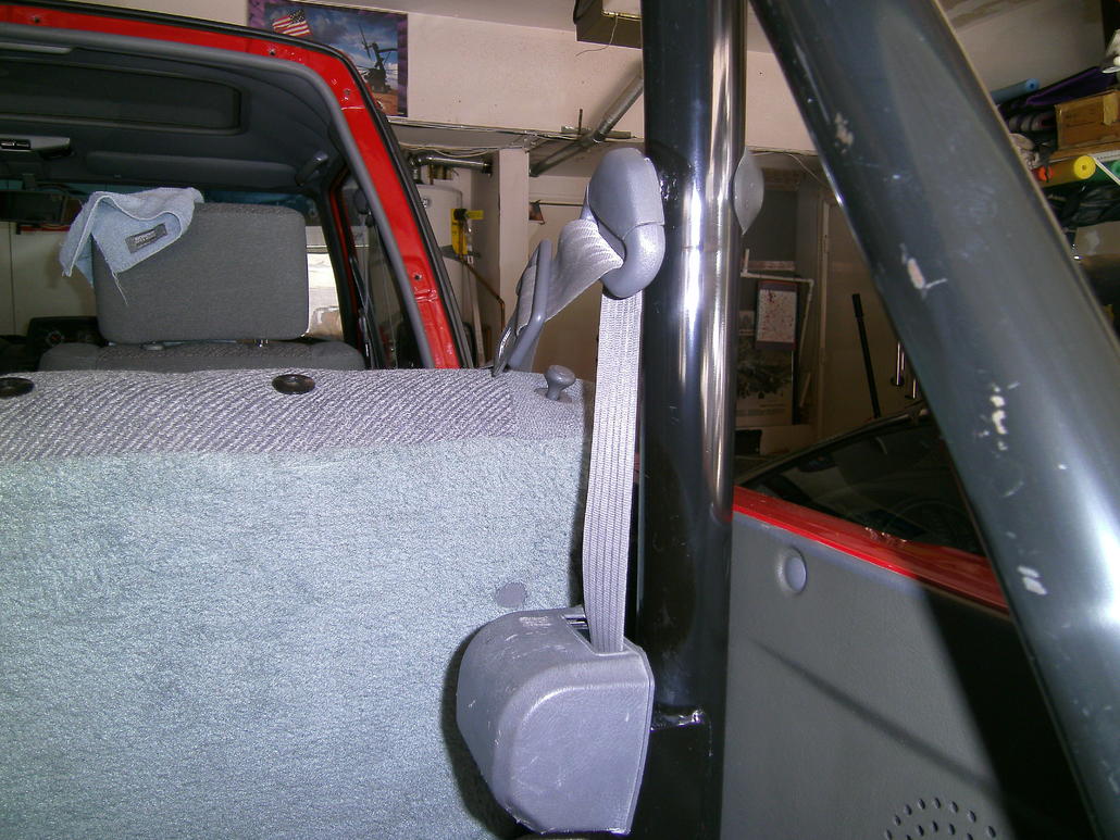

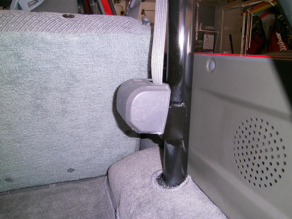

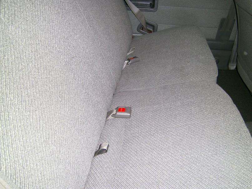

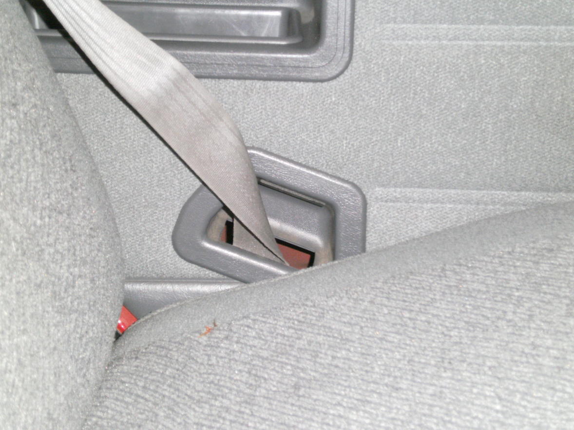

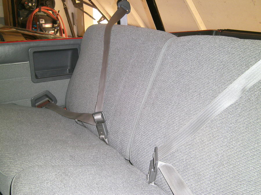

Once my son jumped in the back seat and I noticed the old lap belt I was hoping there was a better belt. It appears Toyota just never finished the job. Once I did some research and looked over the belt and roll bar mount points it was clear the mod would be fairly clean.
There were several older threads of folks adding the 3 point belt using the roll bar mount for the lap belt retractor and the shoulder mount. I spent a couple hours at the local pick a part and found the retractors and all of the small accessories. I still need to find a good fitting cover.
A few pics

Looks Clean, kc15842!
Most of the write ups say get front shoulder belts from similar year trucks.
Yeah, first I used parts from a second gen 4Runner but retractor did not have a cover. Then I found same year truck with cover for retractor so I switched to that.
Problem either way is that the belt is too long so it's got slack now.
I remember seeing from either this forum or yotatech where someone used belt from a Subaru and did not have the slack.
I had to cut both sides too. My wife has a very nice sewing machine that does a real nice job sewing the webbing material. I see you're in SoCal, like neighbors. I'm sure I can talk her into a couple more.

that would be me. used rear belts from a '95 legacy. exact fit, using subaru hardware, which fit the toyota mount points. no slack in belts, but no covers for the retractors. i can live with that. also used the subaru middle belt (might as well have it in there).
