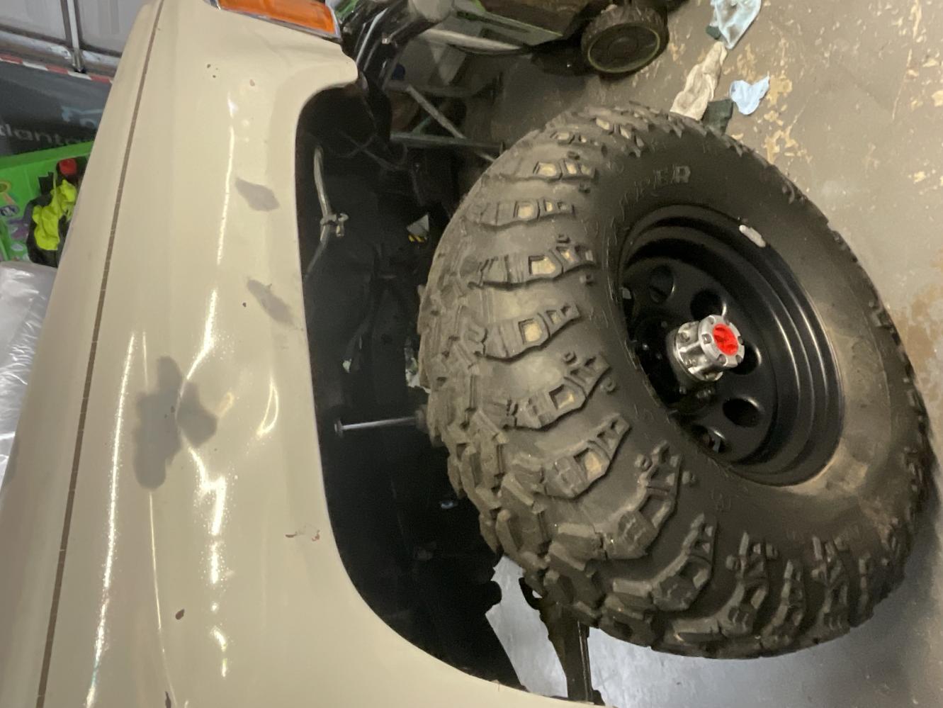

Sale that mall queen
And get a Real 4Runner can’t do much with those here a pic of a real one
