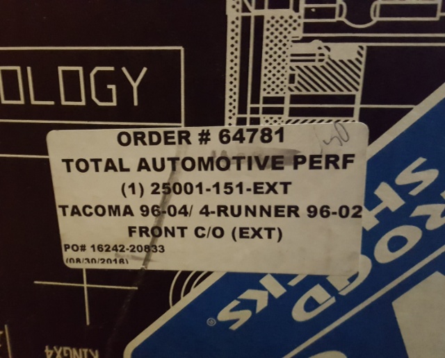

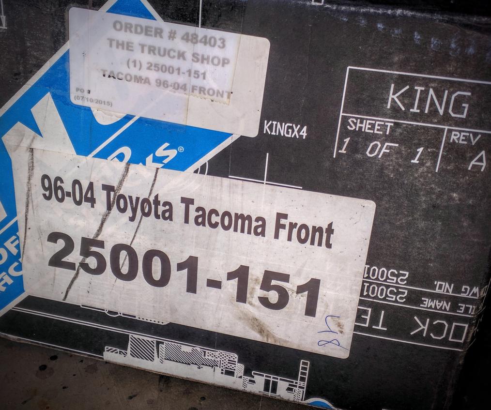

Oddly enough, upon closer inspection although my order read,
KING OEM Performance Series (25001-333EXT)
1996 - 2002 Toyota 4Runner
2.5 Front Coilovers IFP
Extended Travel for use with UCA
My box says 151 (EXT).
Did you go with the extended travel Kings? From what I hear, they are all the same, however, their is a little removable buffer in the non extended versions that can be removed to make it extended travel. We are not really talking about a lot of extra travel anyway, but there you go. I am somewhat curious as to why they sent me 600# coils on mine. I said 650# but told them what I had as far as weight goes and said if they thought I needed 700# given additional weight of skids, winch, front AOR bumper, then go for it. But 600# is what I ended up with. The ride is very nice by my estimations. If I need to, I can jump up to heavier springs down the road.
They give about 1" additional travel. Same thing happened to my brother ordering his icon on 4th gen. Metaltech said go with the 600s.
This makes me wonder if the 333, or 333EXT is the same as the 151s...
I did not get extended travel. Not sure how much extra that gives. Seems good so far.
It's not that big a difference really. Also if you are running extended coilovers, you probably want to make sure that you are running OEM inner tie rods vs. aftermarket ITRs so that when the shocks are at full droop, they are not over stressing the angle on the ITRs. A few aftermarket ITRs have slightly less range of motion.
Some one on here recently just when the through the rebuild process and removed the spacer / buffer converting them to EXT travel. It seemed like a fair amount of work for such a small difference. But hey.. I would be fine with either.
Good to know, maybe we tend to go a bit hard core on what coil weight we think we need.

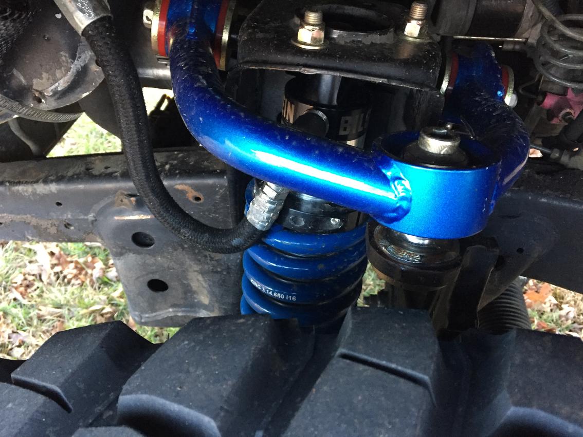

When I rebuilt mine this summer I wanted to jump up to extended. Well. As I tore things apart the internals looked nothing like what people had said. "Remove the 1/2" metal spacer and that's extended". I had no metal spacer.
What I did have was a large metal washer and rubber bump stop to dampen the rebound of the piston from smacking the seal head.
I talked to down south and they said you can remove the rubber bump stop, I called king and they said don't remove it. So I trimmed it down from 1/2" thick to 1/4". Yeah. I know a lot of improvement gains there. But oh well.
BUT. The real gains was on installation. I noticed that at full droop my spindle will not contact my spring. That's common on extended travel. As the suspension drops the upper ball joint / spindle moves closer towards the shock as it lowers. With more slack in the shock length the spindle can contact the spring. Well lucky for me I'm 1/8"-1/4" away from my spring.

What UCAs are you running? And you were hitting the spindle before you trimmed the bushing and now you're not?
Built right uppers.
No I was not hitting them because my upper ball joints were my limiting factor.
Now after the bushing was trimmed. I am close, but not hitting the coil.

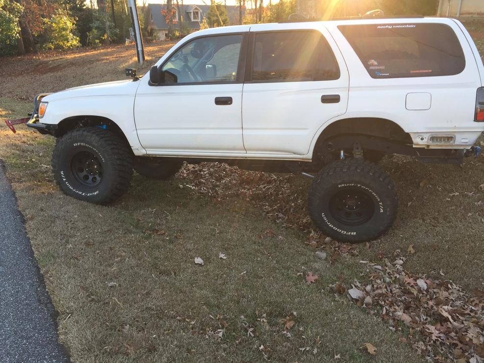

Here is what I'm dealing with. When I installed the Kings at their defaults my lift appeared to go down 0.5" from 29.0" with the Billstiens to now 28.5" fender to ground with Kings. I measure this on the street. Twice is a flat spot near my apt. It seems very flat. It is also the same spot I measured before installing the Kings. I'm pretty solid I lost ~ 0.5" ok fine.
So I go to my mechanics and ask him to raise is 0.25" . They start then tell me that my alignment was done wrong, the wheel was too far forward I believe. And that fixing alignment should stop the rubbing that showed up. He also says sitting in the flat alignment bed which is level that my truck tilts to drive side 0.5". I'm like fine sure. He suggests just fixing the alignment and raising the sagging side. The finish and don't charge me since they originally did the alignment. Fine I go home.
Now today I measure in the exact same spot and now my fender sits at 28.0" - 28.25" using same spot and same technique.
So WTF is happening?
I'm now down nearly whole inch and I haven't added any new weight to the truck. Gas difference? I don't think so I only have 1/4 at moment. The most obvious answer to me is the guy who adjusted the coils lowered them instead of raising them. That simple.
Btw I counted the rings from top of coil adjustment to top coil and I'm pretty sure it is 11 rings at front of truck side of the coil.
