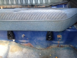

I started with the bottoms. It was clear that the bolt holes weren't going to be the same. But while I had the seats mocked up like this I went ahead and marked where the new holes were going to be.

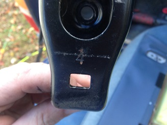

First I pulled off the hinges from the frame and the hinges had the number 3 or 4 stamped into them so I marked their location.

I went ahead and cut the hog rings and pulled the cushions off the frames to protect them from and grinding and welding I might do.

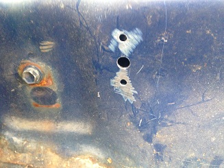

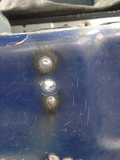

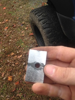

So then I decided I'd drill the holes in the body that I had marked and my plan was to use a 1/8 flat bar with a nut welded to it to reinforce the bolt holes. And to keep the installation and removal of the seats in the future easy I drilled 2 smaller holes on both sides of the bolt hole that I will later fill with weld to keep the nuts in place.

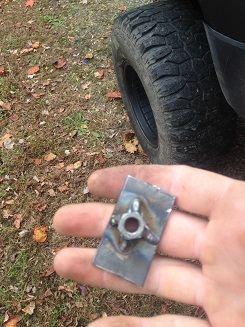

Here are the brackets I made with grade 8- 3/8 nuts tacked to the back.

I was able to access the area that the nuts needed to be from the fuel pump access hole for the passenger side. the drivers side I needed a helping hand. I just put a bolt through them for the time being just to get them welded up.

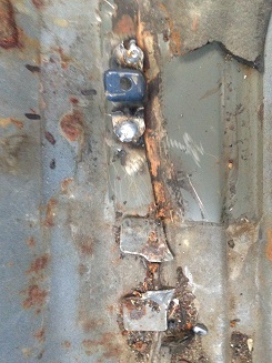

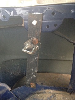

Now that the frames were in I had to relocate the catch on the floor that keeps them down. The factory ones were about 3" off from where they needed to be.
Heres the new one in and whats left of the old one I cut out.

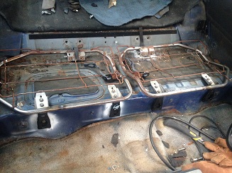

This was a trial and error process. I pretty much eyeballed where I thought they needed to be and tacked them in and actually both sides worked the first time so I went ahead and welded the spots fully. (I drilled the spot welds and got the factory latches from the donor rig)

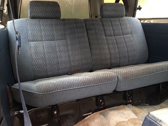

Heres both frames in and latching down.
After reattaching the cushions with zip ties (temporary in case I needed to remove them again) I had to tweak the catches on the floor a little. Both seats latched but wouldn't release but a few taps with the ol hammer they work great.

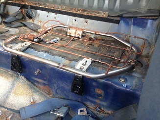

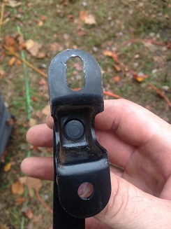

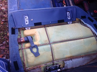

Now the seat back. The center hinge for the seat back was direct bolt in and the sides were close. The bottom hole on the side hinges was already elongated but it needed about 1/8" more.
That was the easiest part of the back seat so far. However the seatback latch system was nowhere near compatible. Although my catches were mounted to the rollbar after I took off the side interior panels I noticed that holes were already there for catches but they were way too high for the 2nd gen seats. So I put on the thinking cap again and got to cutting and grinding. After a lot of eyeballing and 2nd guessing heres what I came up with
Its a 1/4" flat bar that actually started life as the catch for the original seat. The lower hole in the body was already there and the metal was flared around it so its actually a pretty strong hole. I mounted the catch from the donor vehicle where it looked like it needed to be and then drilled the top hole. It was the same with the floor catches, it needed a couple persuasive blows from the mall to latch correctly but works quite well and is very rigid. I did the pass. side first and used it as a template for the drivers side and once bolted in the drivers side worked flawlessly.
So heres the finished product.
Now all that's left is to re hog ring the cushions on and decide on new seat belts. I know that the existing holes in the rollbar that previously held my catch is where many guys mount the belts so that's my next move. If any of you want to tackle this project and have any question feel free to ask and please guys don't hesitate to criticize my work if you feel you know a better way. I am a floor covering installer that likes cutting and welding crap in my yard so I am far from an engineer and I know that so please if you see something that can be improved leave it here for the next guy.
