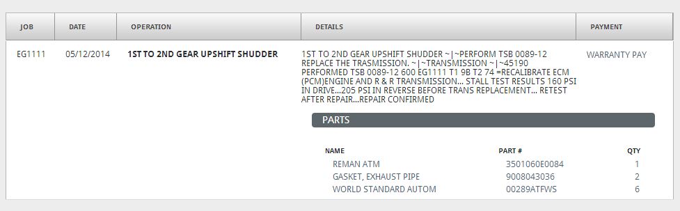

Replaced transmission
I took mine in 2 weeks ago and they replaced the entire transmission under the TSB. Was surprised since I just expected an ECM flash.

Do you have that TSB number?
Here is what they sent me. It's all the info I have. It only lists 1 TSB but the service attendant said it was the result of "following the chain of linked TSBs based on the VIN".
