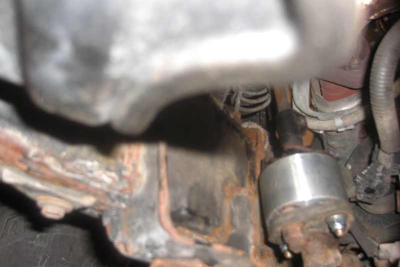

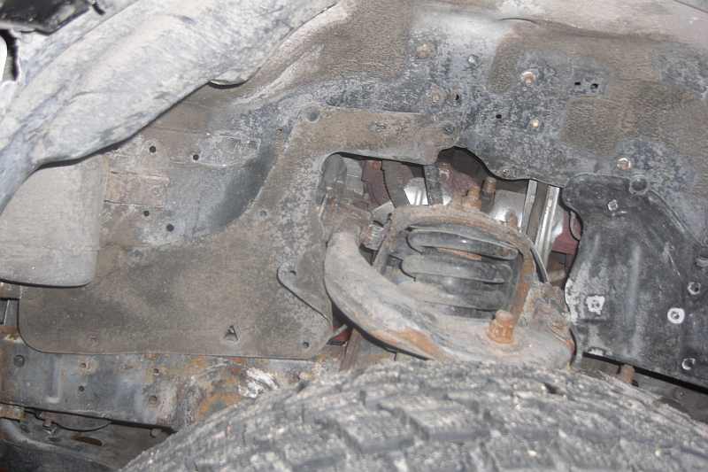

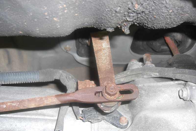

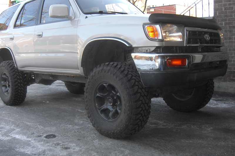

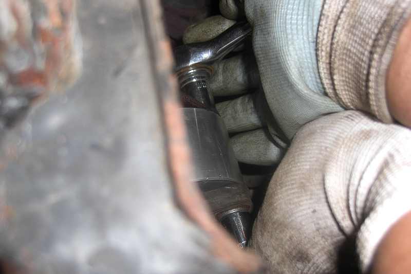

I installed my BL last Wednesday. I made sure I spray all the nuts including the bumper there is four bolts and two nuts in front of the wheel well and the two bolts on steering column and one nut on the Automatic Transmission with PB Blaster. I did mine couple of days while waiting for the lift to arrive and the nuts come loose easy. Next project slider, bumpers with winch and tire carriage. Here are some pics.

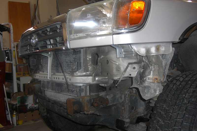

looks good but what are you going to do about the bumper? That is one thing I have questioned about a BL on the 4runners. I wanna get a 1 inch but i dont want the front bumper to have a big gap in it.

Like I explain on my post I'm fabricating my own bumpers and slider. I have the tube 2" /.120 bars already. I'm just waiting for my friend to help me build it.

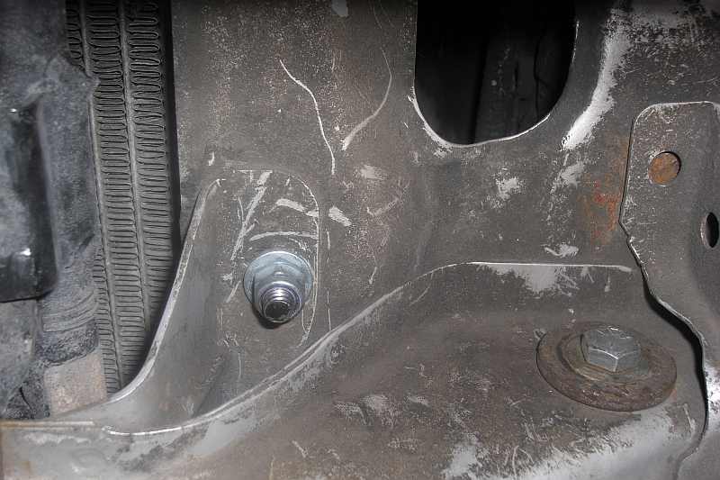

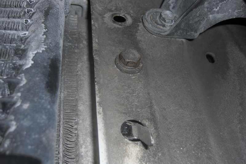

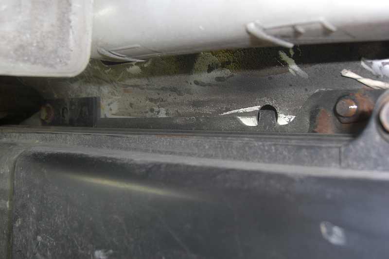

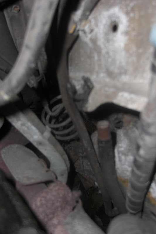

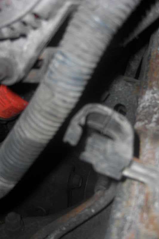

Radiator drop is the easiest one for 2" bl lift. The next hole under the hook is perfect 2" down. and you can use the stock bolt. I order radiator drop thats the one I use for the bottom holes, but you can use thinner bolts and nuts with washer for the bottom holes. There is one hole align with radiator hole using thinner bolt. No drilling. Make sure you disable the clamp for battery harness and front diff. breather when you lifting the body.

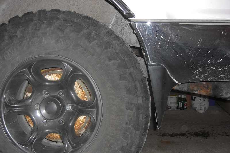

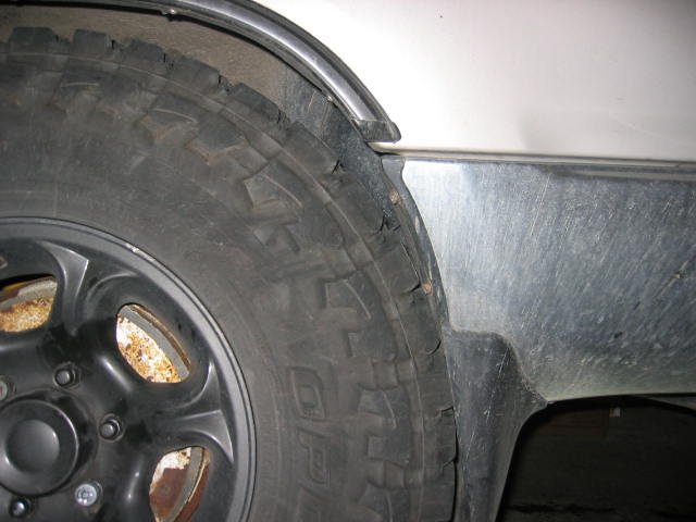

3" suspension lift and 2" body lift
Before BL....3" suspension lift with 285/75/16 full flex rubbing on offroad. After the 2" body lift clear the rubbing.

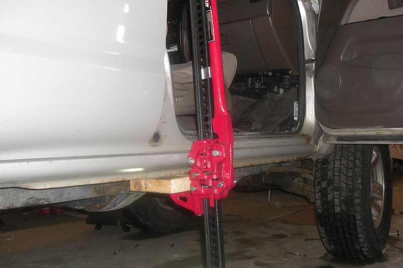

Snowrunner: Where did you lift your body off the frame from?
I lifted it on the pinch weld on the middle of the front and rear doors with piece of wood block on the hi-lift. I posted pic #1. BTW its 4x4snowRunner....there is another sn0wrunner here.
