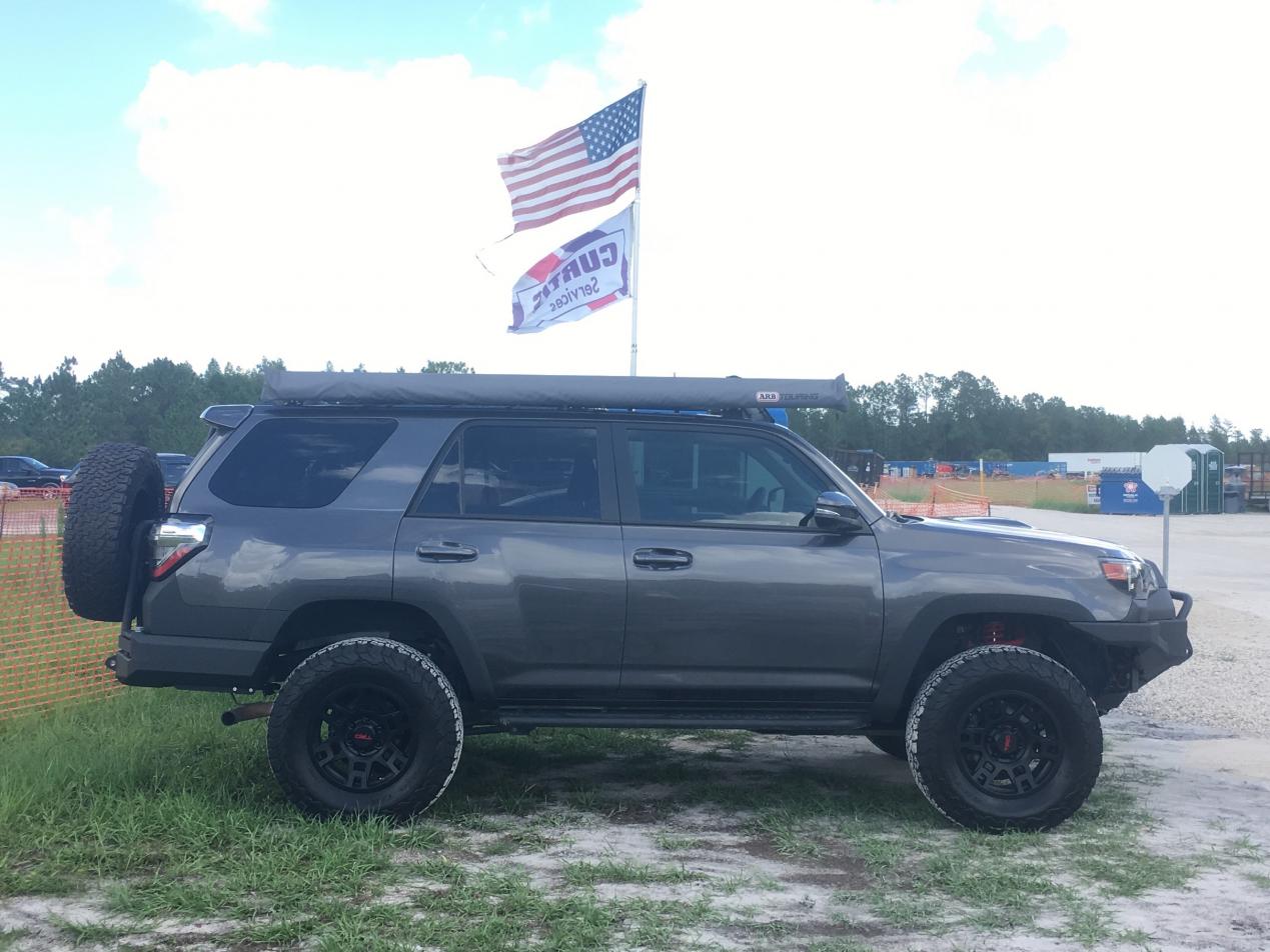

you "shouldnt" need anything extra even if you max the 6112's out. 2" all around will look good, back end will be up a bit so its not sagging when you load up with gear. 2" will also allow a better alignment with stock uppers.

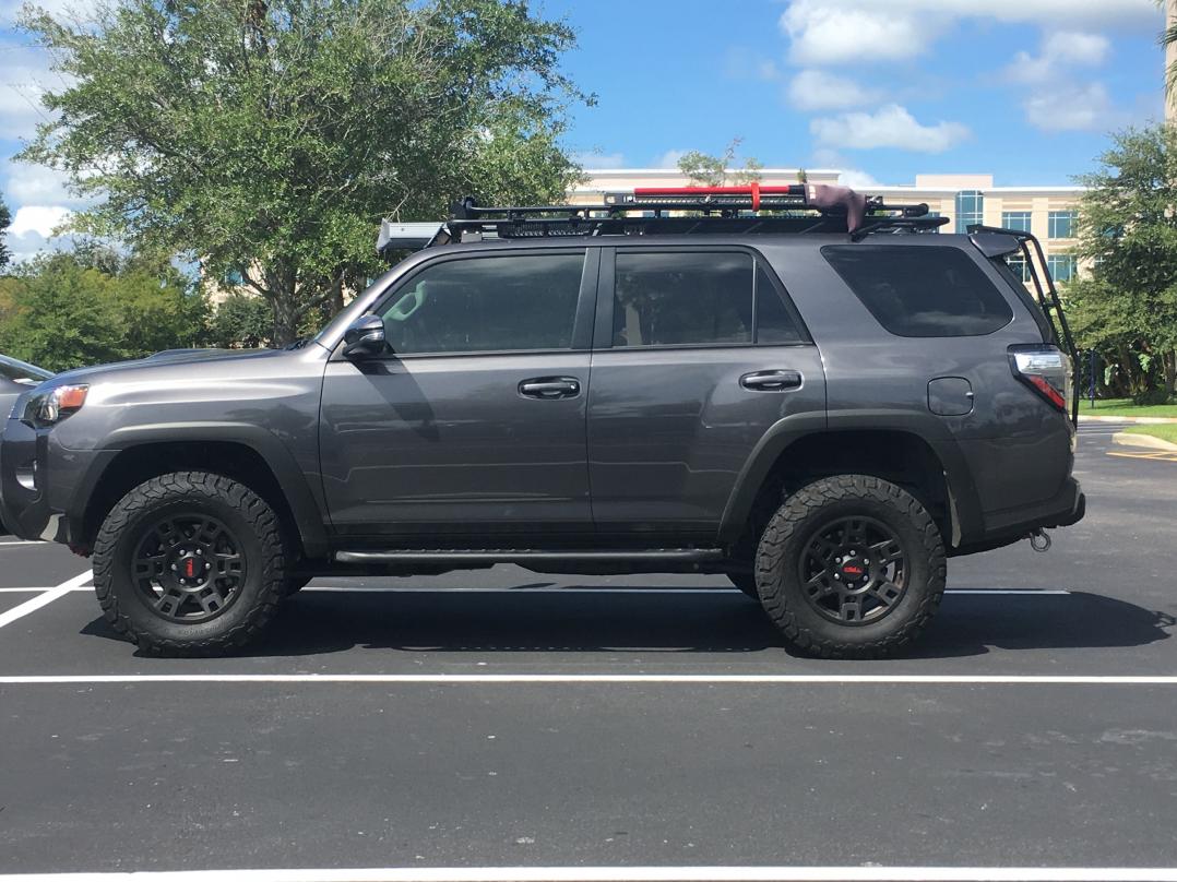

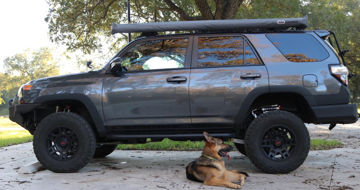

some pics of the setups I've had, these may give you an idea:
1.7"F Bilstein 5100 & 2"R superflex
~3"F Toytec & 2"R superflex
~3"F Kings & 3.5"R Dobinsons
UCAs help significantly with alignment and handling at 2.5"+ so that might be a consideration to make as well
