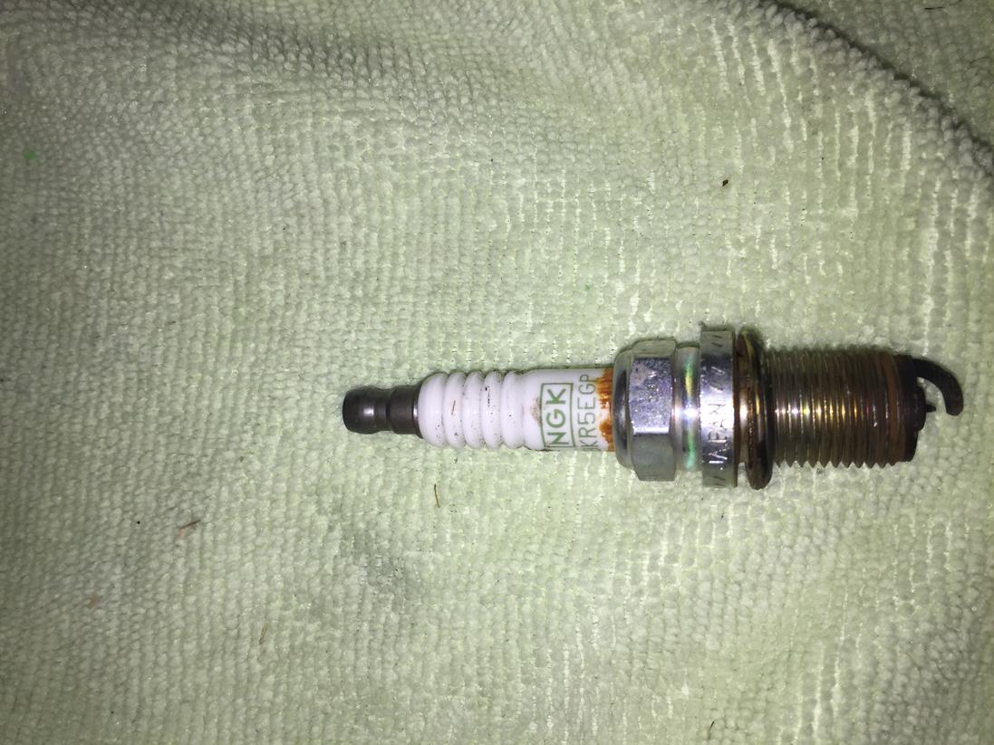

What does #2 spark plug LOOK like? (First thing I do on a single cyl miss is eyeball the plug.)
If those come up good, I would swap injectors with another cylinder. Known good>>>rebuilt injector out of the box.
I think it looks fine but then again I don't know what to looking for

1. It's the wrong plug. You want a double element plug. Did you replace with the same plug or get the right ones?
2. It definitely needed to be changed.
3. Not looking like a head gasket issue.
4. Black dry deposits suggest it running rich, so maybe the plug is wrong heat range or maybe you have a sensor issue (MAF, O2).
I'd prefer a better angle on the business end, but that's a start.
As Durk said not a HG issue the way that plug is looking. Definitely running rich.
How long have those plugs been in there? How did the plugs look on cyl 4 and 6?

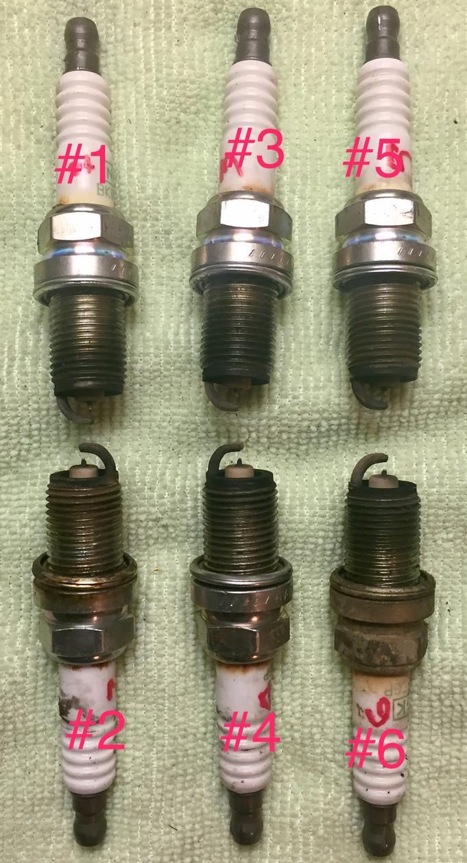

Following your suggestions: I replaced my spark plugs and all wires with NKG double grounds spark plugs. I also cleaned the MAF and TB.
While I had the plugs out I did a compression test but not sure what to make of it. I've never done this test before so I'm NOT confident with the accuracy.
1 - 195
3- 200
5 - 190
2 - 190
4 - 180
6 - 190
I attached a pic of the old plugs too for any spark plug readers.
And after all that the 4Runner seems to be running better than before but i haven't been on the road yet.
Those are Iridium plugs which are recommended to run with a supercharger because you want a colder plug. I run the Iridium Denso IK22's with great results and no pinging. However, the electrode tips do look worn, hard to say just from looking what the gaps might be.
You can run double-grounded copper plugs with a supercharger but you might get some pinging from it. If there was a double-grounded colder Iridium plug that'd be perfect, but I haven't seen one at a decent price yet. The single ground basically cuts their lifespan in half and can cause the gap to get too big. The second photo resembles how my spark plugs look color-wise, maybe a tad bit lighter though.
Your compression number look good though, you'd notice a significant drop in one of them (cylinder 2) if there was a problem with the valves. I would clean the MAF and make sure everything else looks good fluid wise to see if you find any clues, otherwise it sounds to be your injector (if your coil pack was bad, you'd have two cylinders not firing).
They all look a little rich. If the O2 sensors haven't been replaced, do so with Denso ones off Amazon. Shouldn't be too expensive.
Ok. That didn't sound right so you made me look it up.
Not quite. That's a BKR5EGP, so it's platinum, not iridium, and it's the same heat range #5 as the OEM BKR5EKB-11. Iridiums would have I or IX instead of GP. At least that's what the NGK web site tells me. A colder plug would have a number greater than 5. Absent the S/C, the black deposits would suggest he might need a hotter plug, not colder.
As I know nothing about superchargers, I'll stop there, except to say that platinum is not that big a step up from the nickel plated copper, and probably a step down when you go to single element from double in terms of life. Iridium is a different ball game in performance and cost.
BTW, bad coils frequently fail only on one plug or the other. I know it's not logical, but the detection systems are not perfect. I used to think that way, until life taught me different.
https://www.ngksparkplugs.com/assets/design_symbols_plugs.pdf
