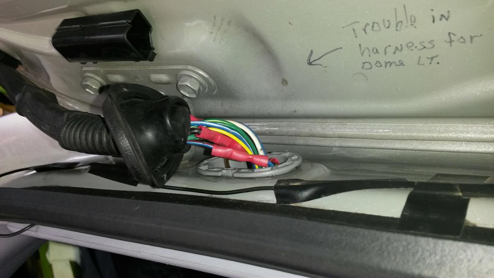

Just wanted to show the areas of concern I have found on my 2000 4Runner with 241,000 miles. Overhead map light not working: corrosion on ground wire. Rear dome light not working, and rear hatch door lock not working: broken wires where hatch door hinges. Clogged Catalytic Converter: dropped it down and flushed it. Works good no more codes.

I've had intermittent hatch lock and window issues. I had opened up the hatch panel but didn't think to check the hinges. :loco: Thanks
