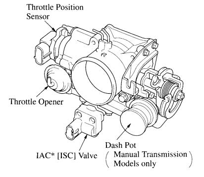

If there is something wrong with the TPS, how would I troubleshoot that? Where is it and what should do?
See the pic below for location. As far as testing it, the online FSM is for 2002 model year which has a totally different TPS and throttle body. Not sure what the resistance values should be for a 2000. Maybe if someone else has a manual for that year they could look it up.

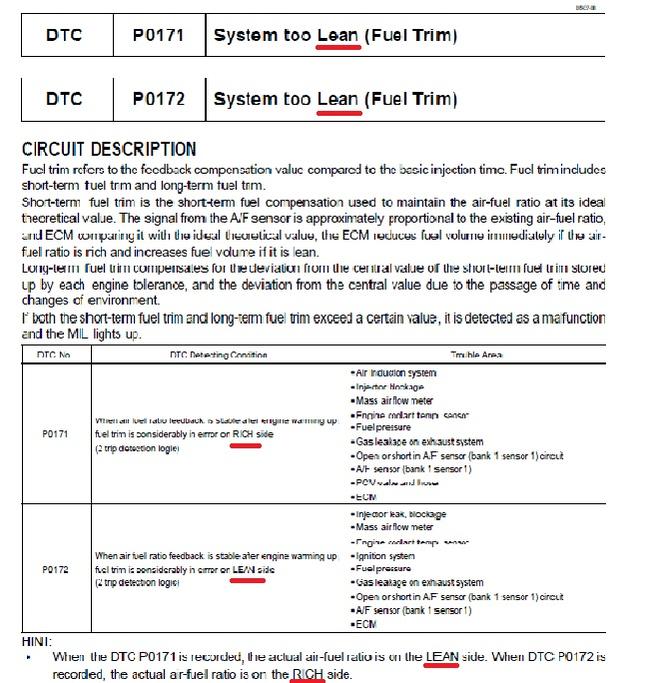

Unless I'm reading it wrong the FSM is confused on what's lean and what's rich.
I would clean your MAF, check for vacuum leaks and then change your pre cat sensor. If that doesn't help then replace your TPS. Or just change it since you've got the code for it a few times now so it must be having some issues.
