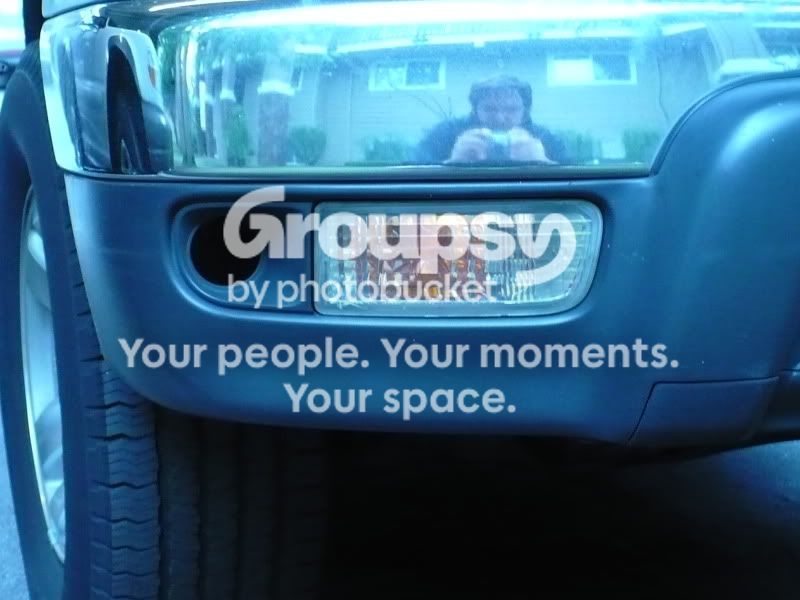

How this came out, I have no idea..
P1020950.jpg~original

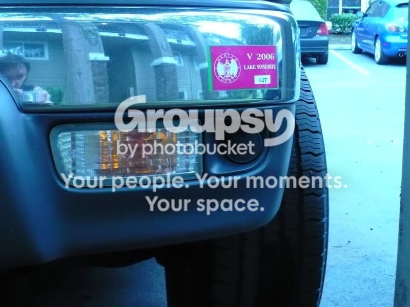

Here is what the other side looks like.
P1020951.jpg~original

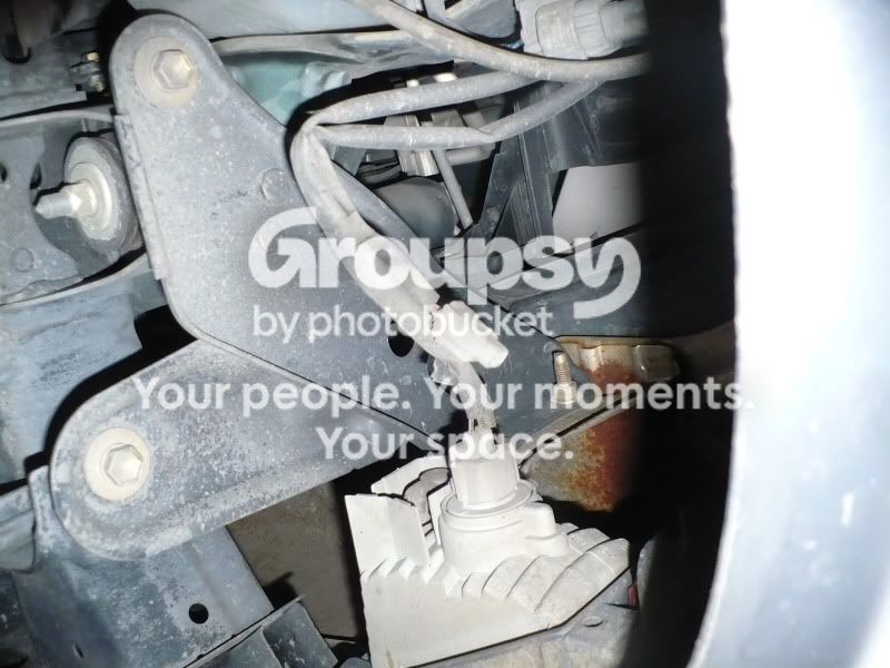

Based on the wiring, I'm guessing that some models have some kind of driving light there.
P1020955.jpg~original

No question about it, those are where your factory fog lights were. If you don't want them, just get another cover for couple of bucks. The OEM fog lights will run you $75- $125 or so each depending on where you get them. They come on a mounting bracket that requires attaching to bumper at couple of places. Easy install.
Hella Micro DEs are the direct factory replacement and they sell a kit which retails for about $170. I'll find the link.
