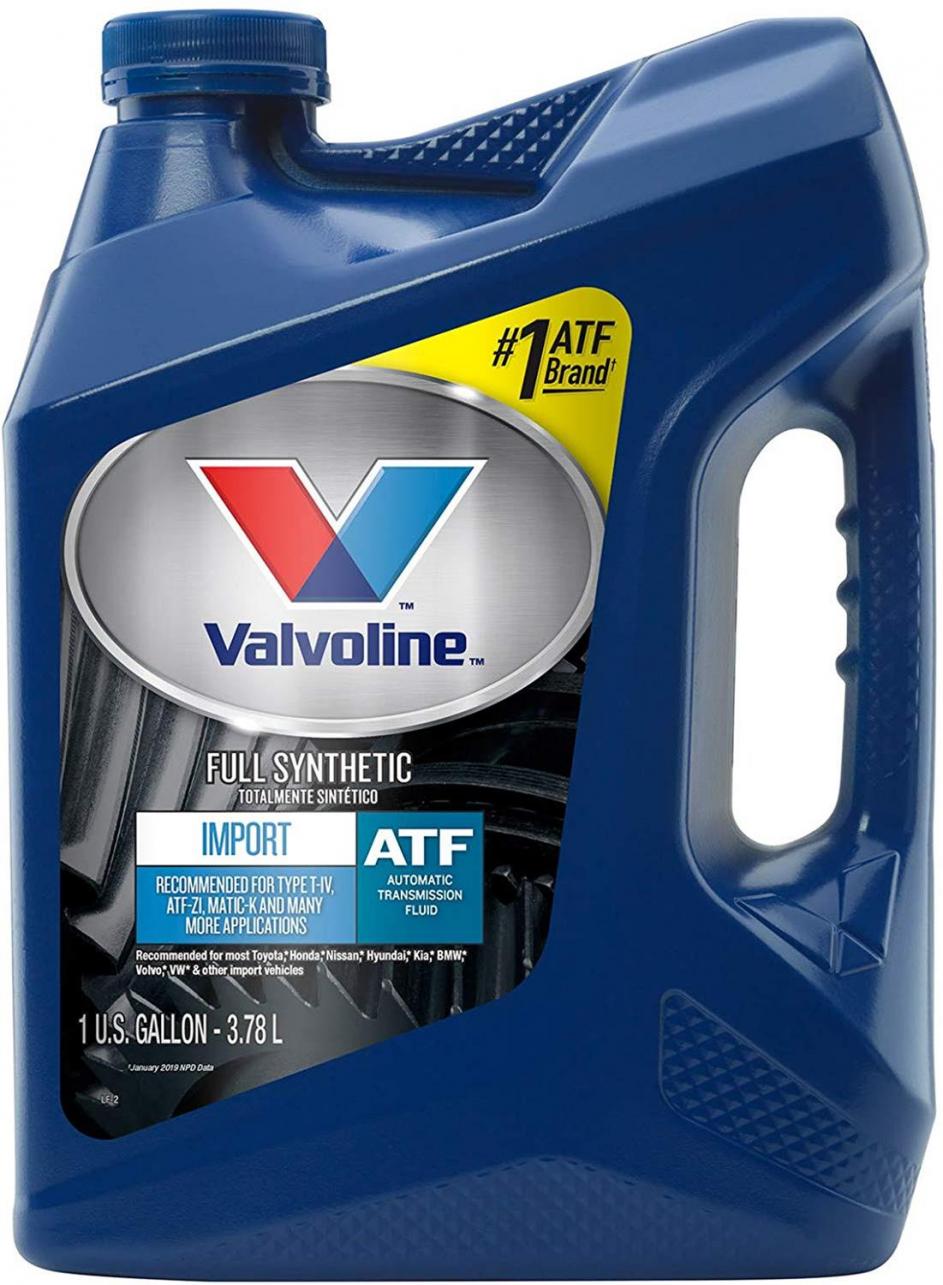

For now I would drain/fill with valvoline import full synthetic (Blue bottle Not the red bottle 'maxlife').
Mine was whinning in 1st thru 3rd, one drain/fill and a couple thousands miles later is slowly went away and now is near silent. Hope it helps yours.
Curious to know why the OP was advised against the Red jug of Maxlife. I have no favorite but happened to use the red jugs last couple drain and fills....
curious also, as I pretty sure I used the red myself. What ever color it said dex 111 compatible im sure. I dont want to run the wrong stuff. Im thinking timmy in his trans flush video used the red jug
