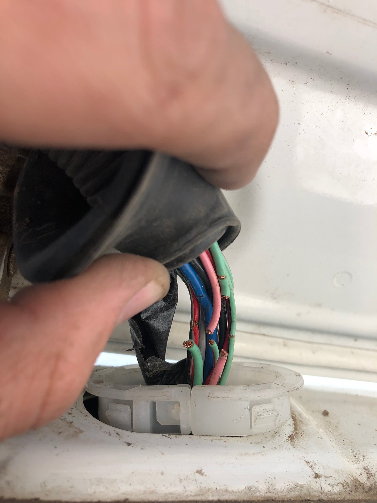

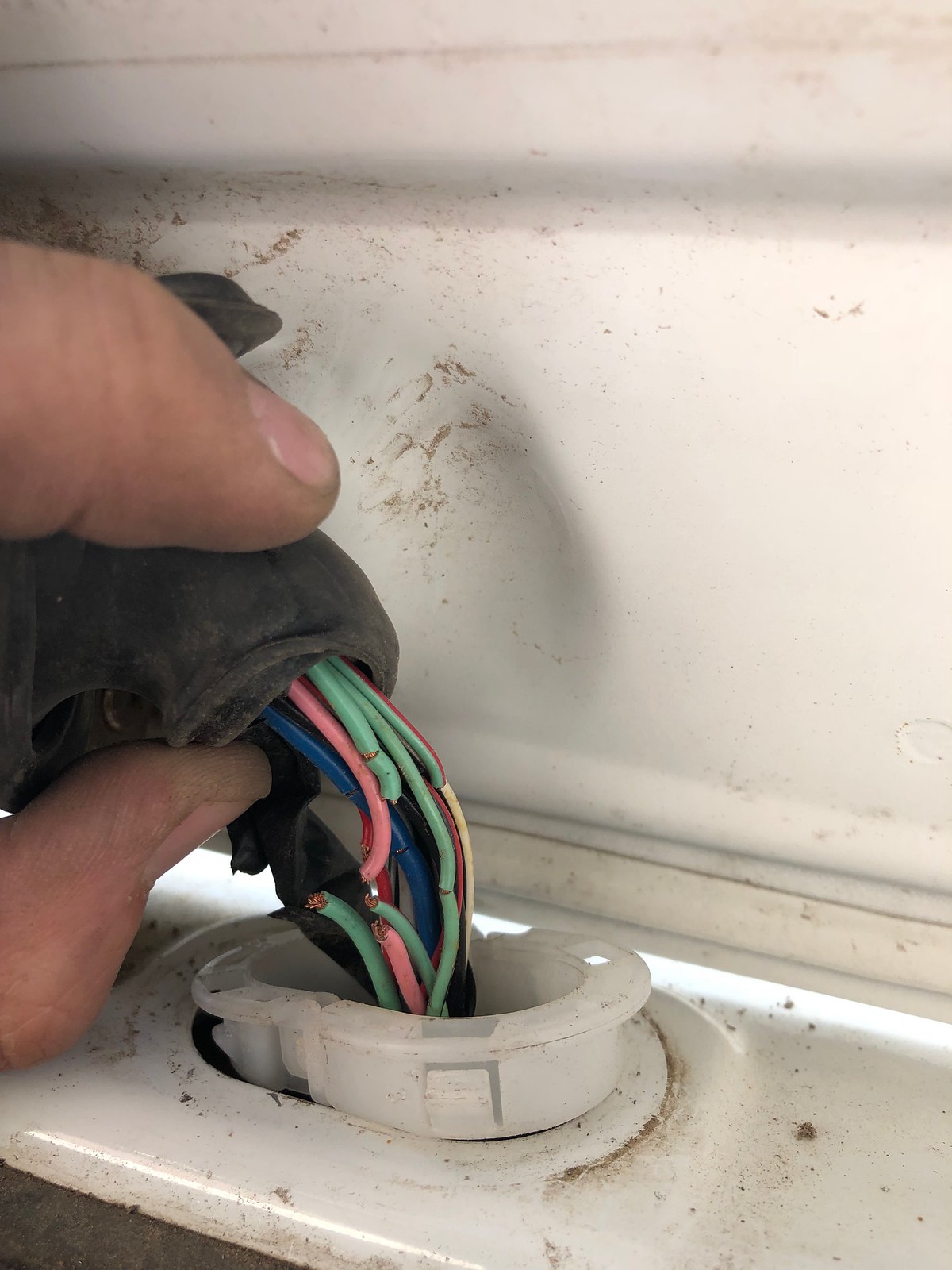

I have had this exact same issue happen. There is a rubber boot that houses wires going to the hatch in the hinge portion of the hatch. Over time the wiring inside of it flex and bend as you open and close the hatch. Eventually they break, if you pull the rubber boot off you and check.
In order fix you need to:
* pop back the side plastics in the cargo area
* remove the dome light and plastic piece holding it in place
* solder the break in the wiring back together.
here are some pictures of the location of the wiring and the breaks in mine. Mine also stopped all wipe function and the rear defroster from working.
IMG_3314 by austin jenkins, on Flickr
IMG_3317 by austin jenkins, on Flickr
