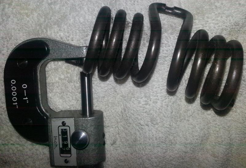

Thank Matt for that advice, as Rockdawg84 is gonna do the nylon P bushing mod next.
Since I replaced the double-coil torsion spring with a Toyota clutch-pedal return spring, I have the extra torsion spring to measure to help out Rockdqawg and others.
Measuring the diameter at multiple places, it's pretty consistently around 0.1975 inches.
