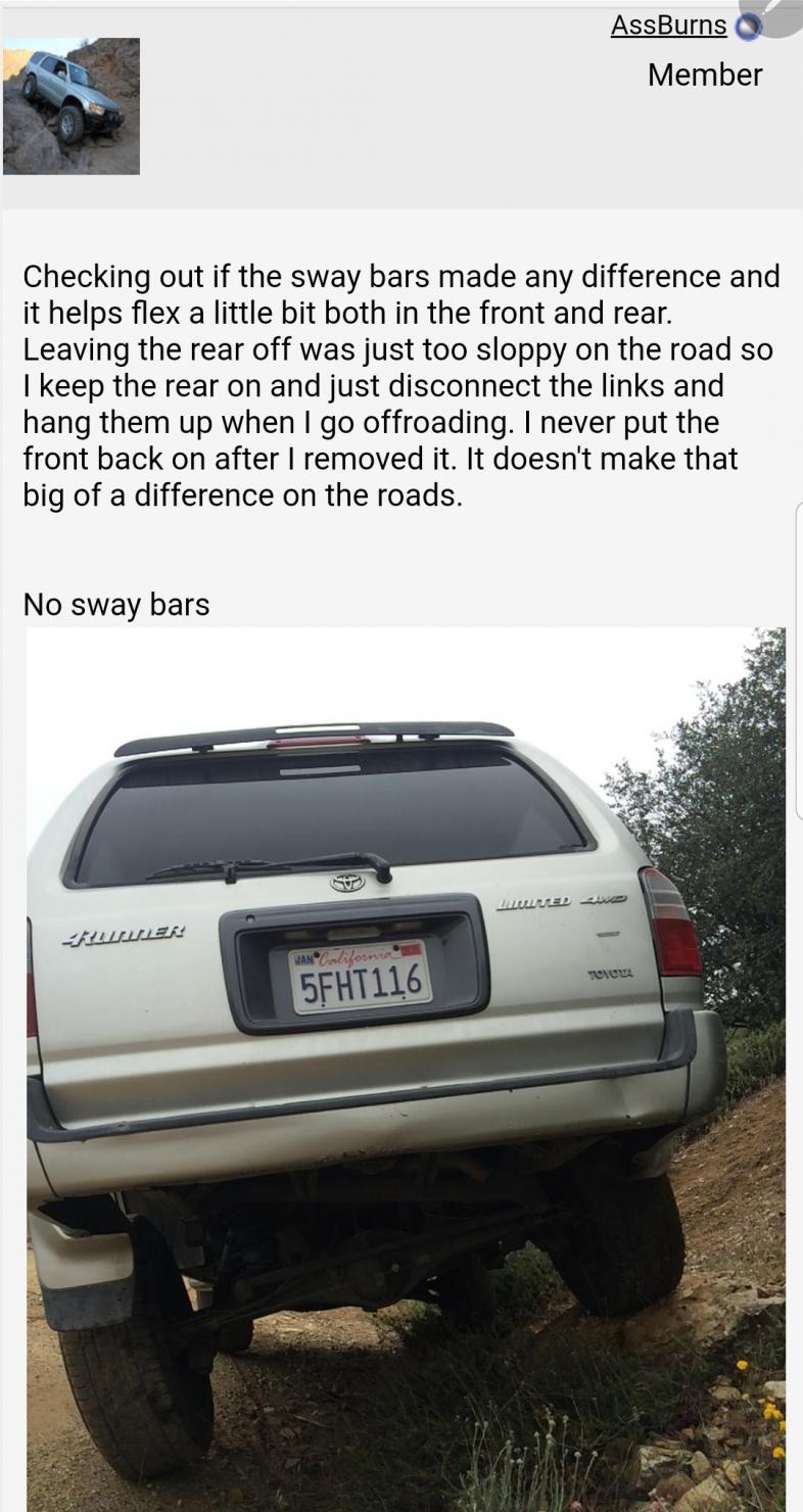

In my personal oppinion with no real info on your truck besides the rocking issue I would say go out and buy literally every bushing for the rear. Unless something is broken or the shocks themselves are blown / in need of replacement due to wear and tear and being old, bushings will fix your problem. In addition to this (this may sound stupid but idk how long you've been the owner of your truck) make sure there is a rear sway bar as some owners do take them off.
Lol as soon as I left this thread I went onto [MENTION=118730]AssBurns[/MENTION] build thread and saw this
