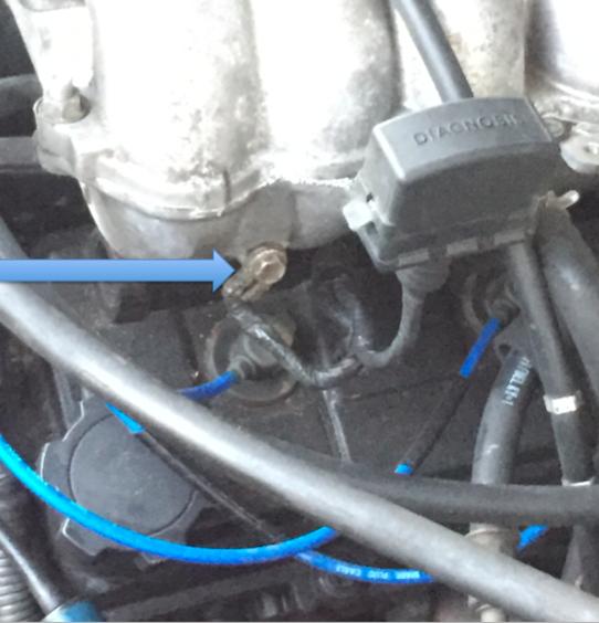

Okay, So the p0125,p0171,p0172,p1130 are all related to the A/F ratio sensor. The P0141 is for the rear O2 Sensor. So, since you have replaced both with Denso stuff, Part #s- should be a/f #234-9002 and o2 sensor #234-4153. If that looks right my only other suggestion would be check the ground that bolts to the intake plenum is tight. I have seen those loose when someone replaced the valve cover gaskets. Hope that helps

So the ground cable on the intake plenum (seen below, I believe this is correct) was just a little loose but still making solid contact, tightened it down to be safe. All hoses seem in great shape, and follow the hose diagram perfectly.
Sorry for poor picture quality, didn't have the time for a better one.

Thanks for the input guys. Haven't really had too much time today to mess with it, lots of tornado warnings in the area so I thought it best to stay inside today. I reset the computer (by removing negative battery cable) and driven about 20 miles. So far no issues since I tightened that ground, normally the codes are up within a minute or two.
We'll see how that goes. Supposed to take it into a shop tomorrow, might just have them do the fuel pump while they're looking everything over if they don't find anything else. They're good on price and I can tell that my gas mileage is still suffering even after just 20 miles.
Fingers crossed it was just the ground, big face palm since I've gone through so much so far. They're running all of the wiring to check everything as well.
