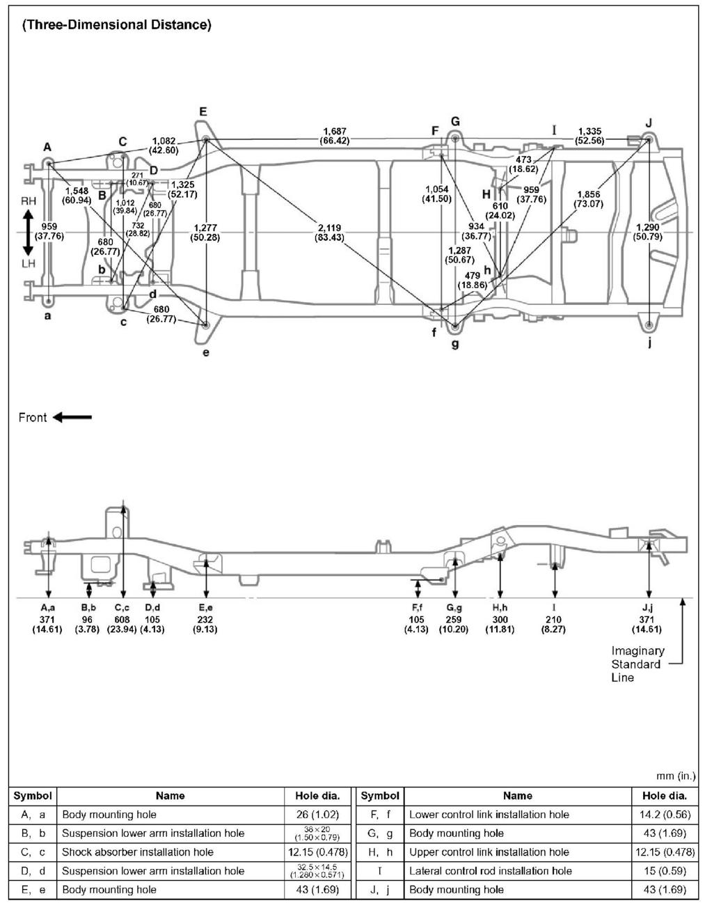

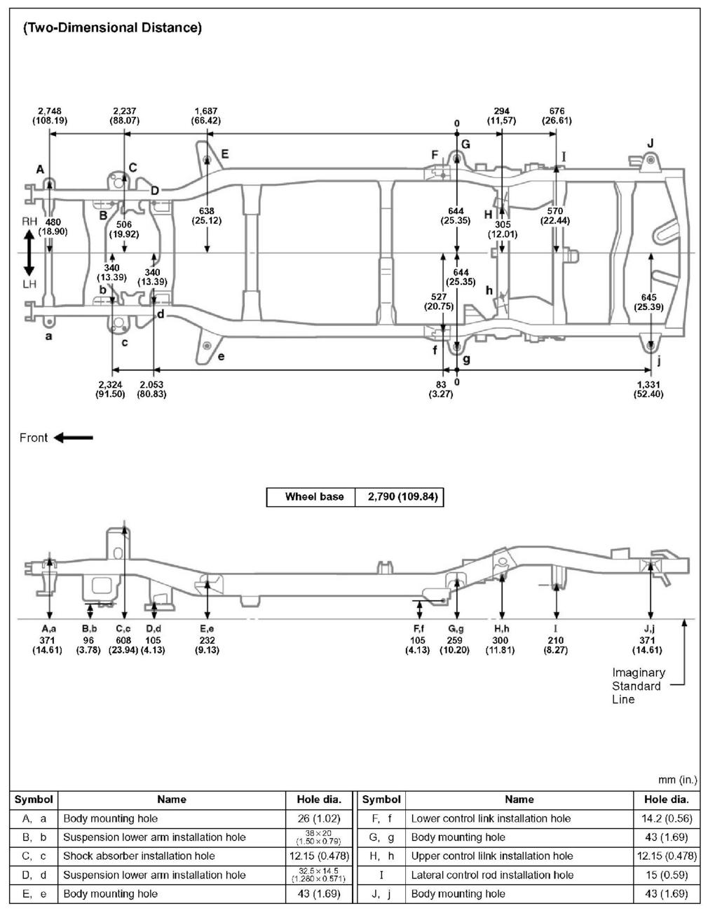

Is this the type of dimensions you are looking for??

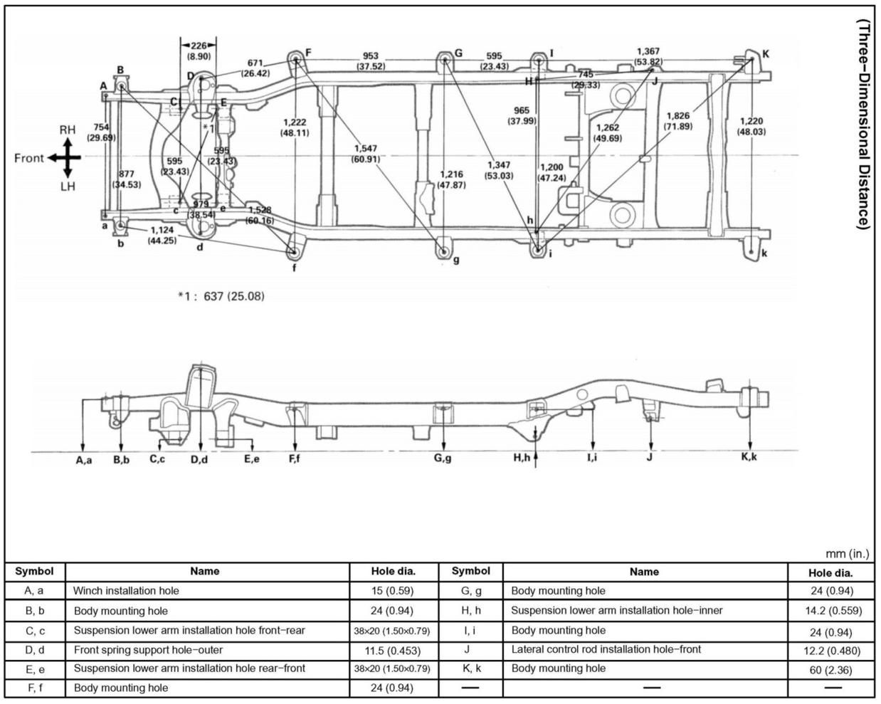

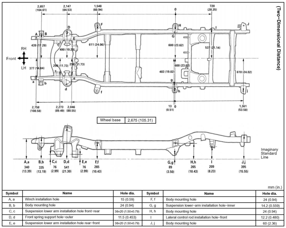

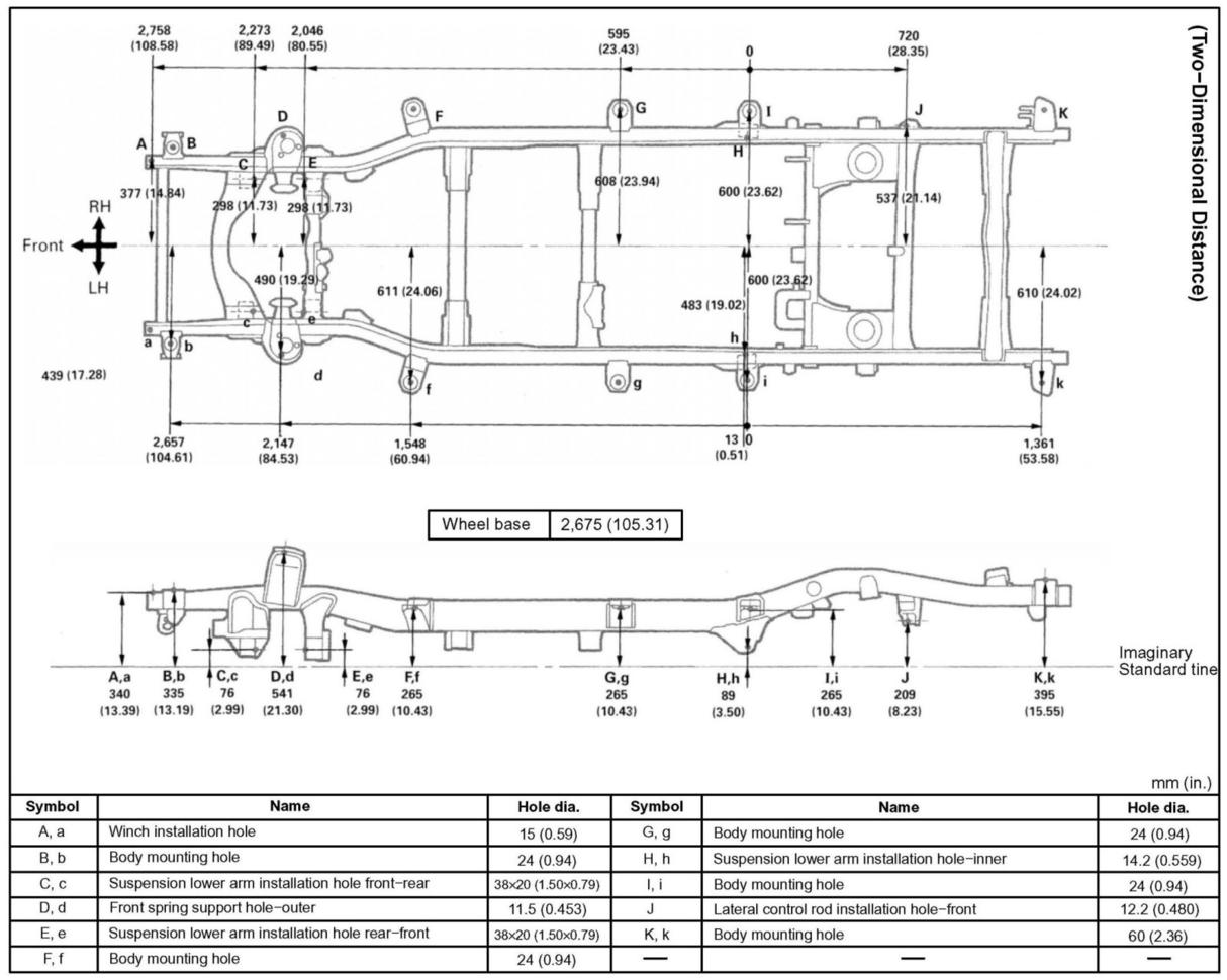

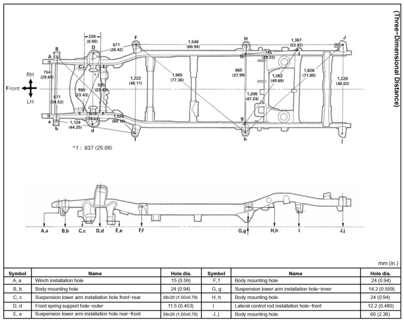

This is for the 4th gen.
Hope this helps a little.
That is kinda what I am looking for but I need something that has axle locations
Doesnt take a rocket scientist to figure out, draw a line from where the Rear LCA mount is to the rear end of the vehicle and then draw a line down from the rear spring and shock mount location on the frame, and where they intersect is where the axle is, if you cant find those then you probably shouldnt be working on cars, but thats just my opinion. I can clearly see it lol.
