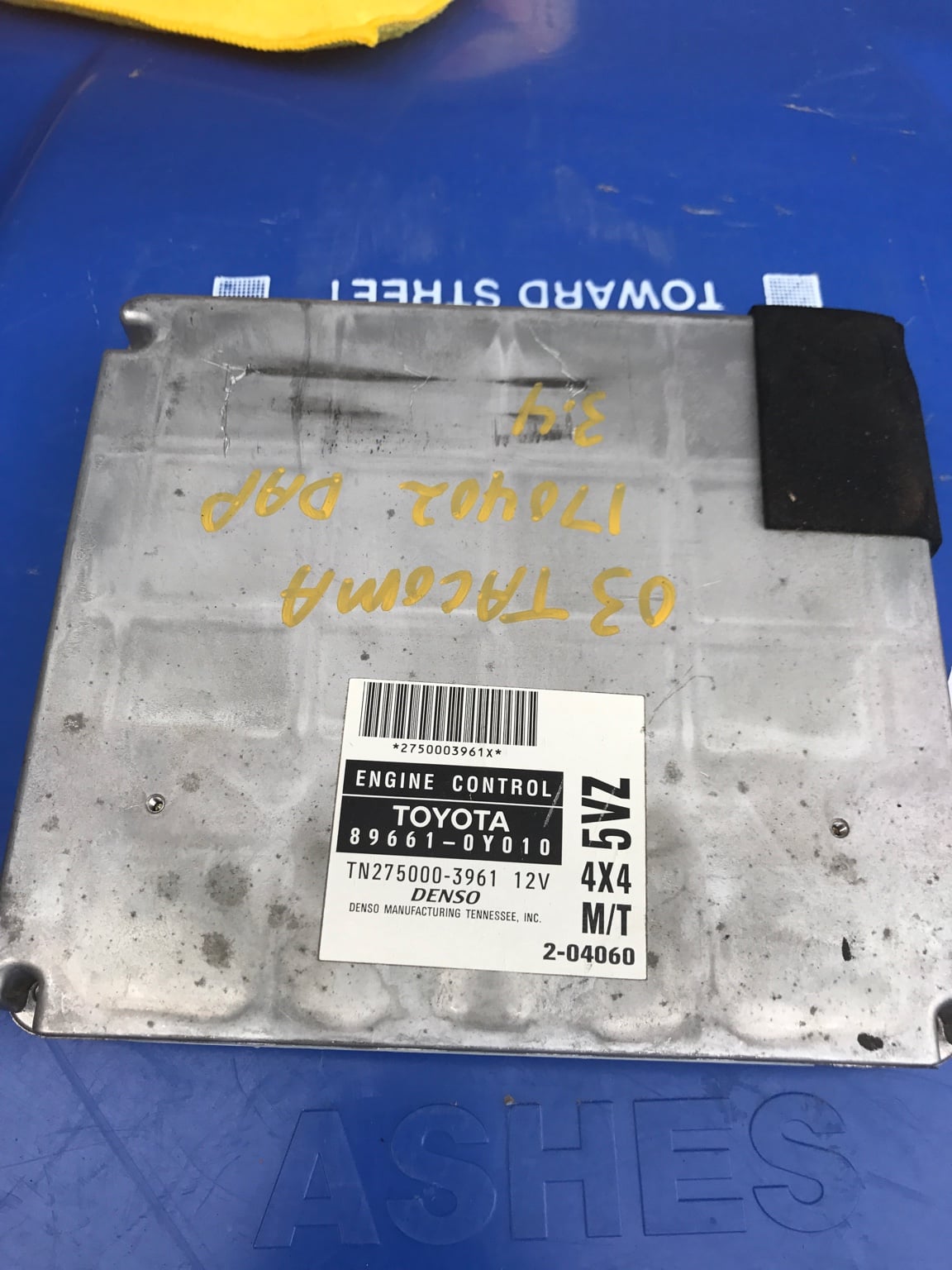

Yeah, the '01/'02 definitely have differences in engine control. I'm not talking about 5-speed swapping or ECM compatibility. I already have an '03 M/T 3.4 4WD Tacoma ECU-
But that's irrelevant.
