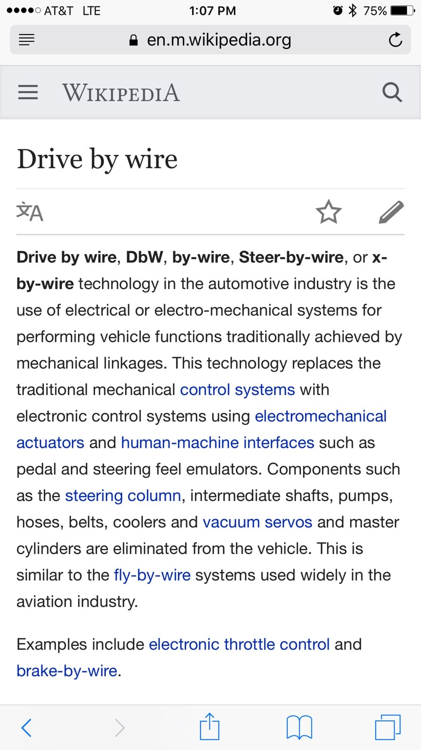

After reading the power point on thottle control, it clearly states 2000-02 runners are drive by cable.
Of course, it also states the '03/'04 V6 Tacoma's are "ETCS-i & Drive by Cable" - which is what the '01/'02 4Runners are (how else would an 03/04 Tacoma ECU be able to run an 01/02 4Runner motor).

Okay, so it's DBW with a remote mounted, cable connected operator.
But not DBW by definition-
Its just easier to explain it as DBW when people are doing head and TB swaps from older to newer vehicles. So much easier to type DBW. Can we leave it at that? We all know your right by definition.
Very well put, I got a case of tunnel vision. Wasn't looking at it in the sense of what TJInc is doing. More me prepping for what might happen to new to me 01.
It is DBW with a cable operated backup... The ECU can disconnect the throttle plate from the throttle cable and control the throttle electronically - that is by definition DBW (no more mechanical link).
