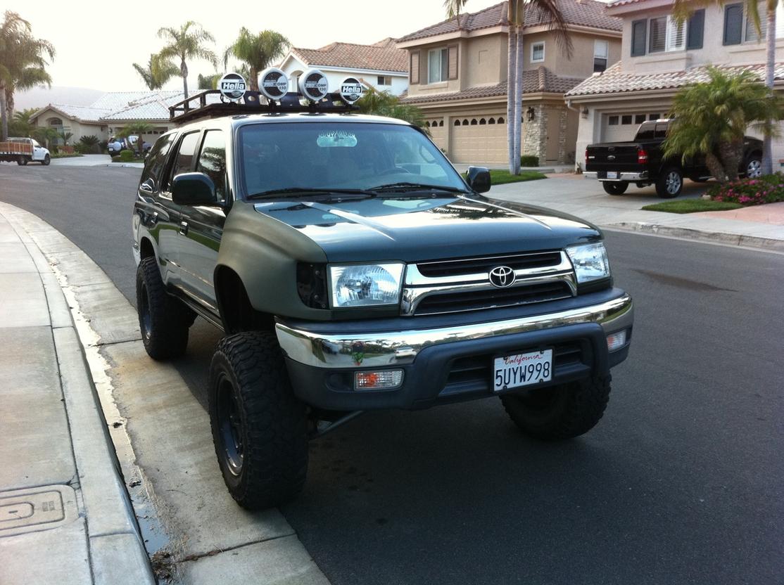

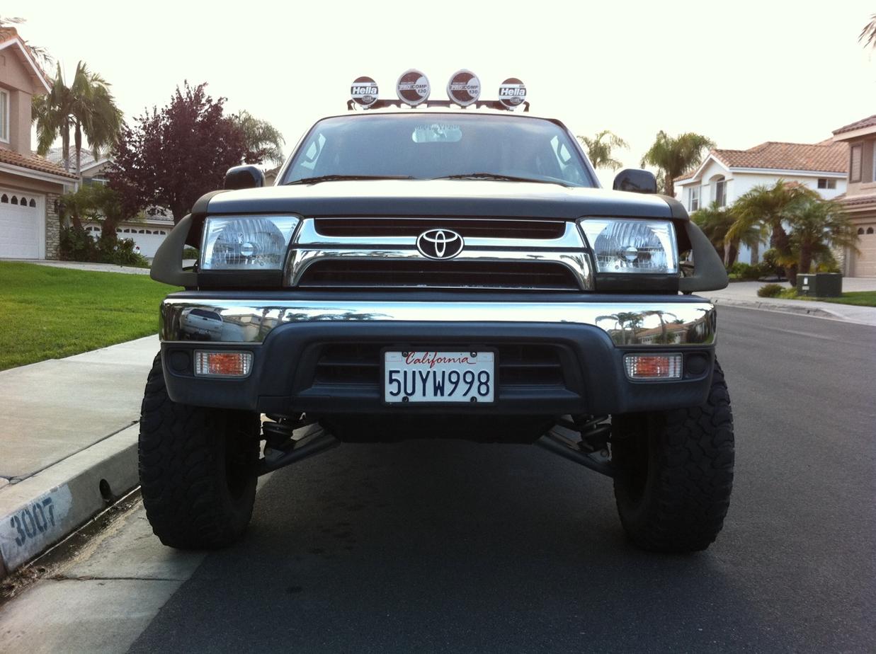

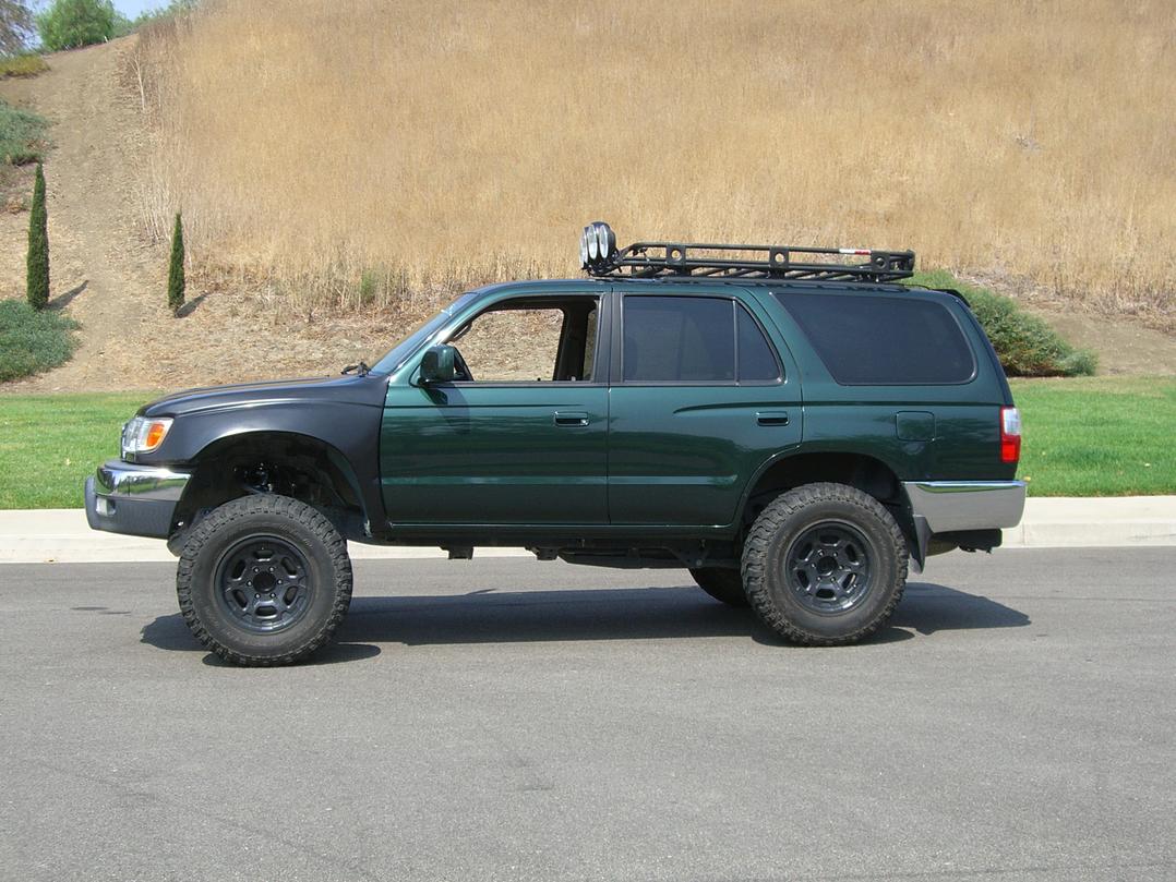

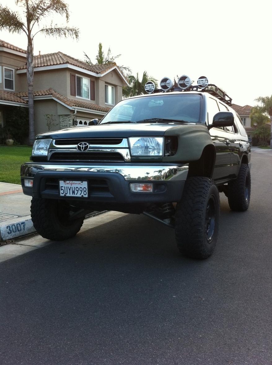

Here are a few pics, unfortunately none are offroad, but whatever:
Front: Total Chaos Front Long Travel w/Fox 2.5 8" Coilovers
Rear: Downey 2 1/2" Lift Coils w/ Doetsch Shocks
