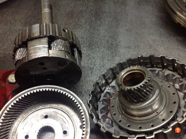

Well, the assessment before they opened it up (last Friday) was that a (the) sprag was "gone" and that I needed a complete rebuild ($2200-$2800). I haven't heard any more yet. I am taking that as good news, as if there were more to that estimate they'd have called for approval; unless they haven't gotten to it yet.

I just got off the phone and they're having to do extensive repair to the OD, I don't know the cost yet. It was the sprag...

OD off buys time, but there's still a negative effect. So far this AAMCO seems legit, they showed me the parts; the OD was shredded and it would have happened anyway. Bottom line, if you hear something, don't wait. Rebuild with new OD gears is $2900 here.
