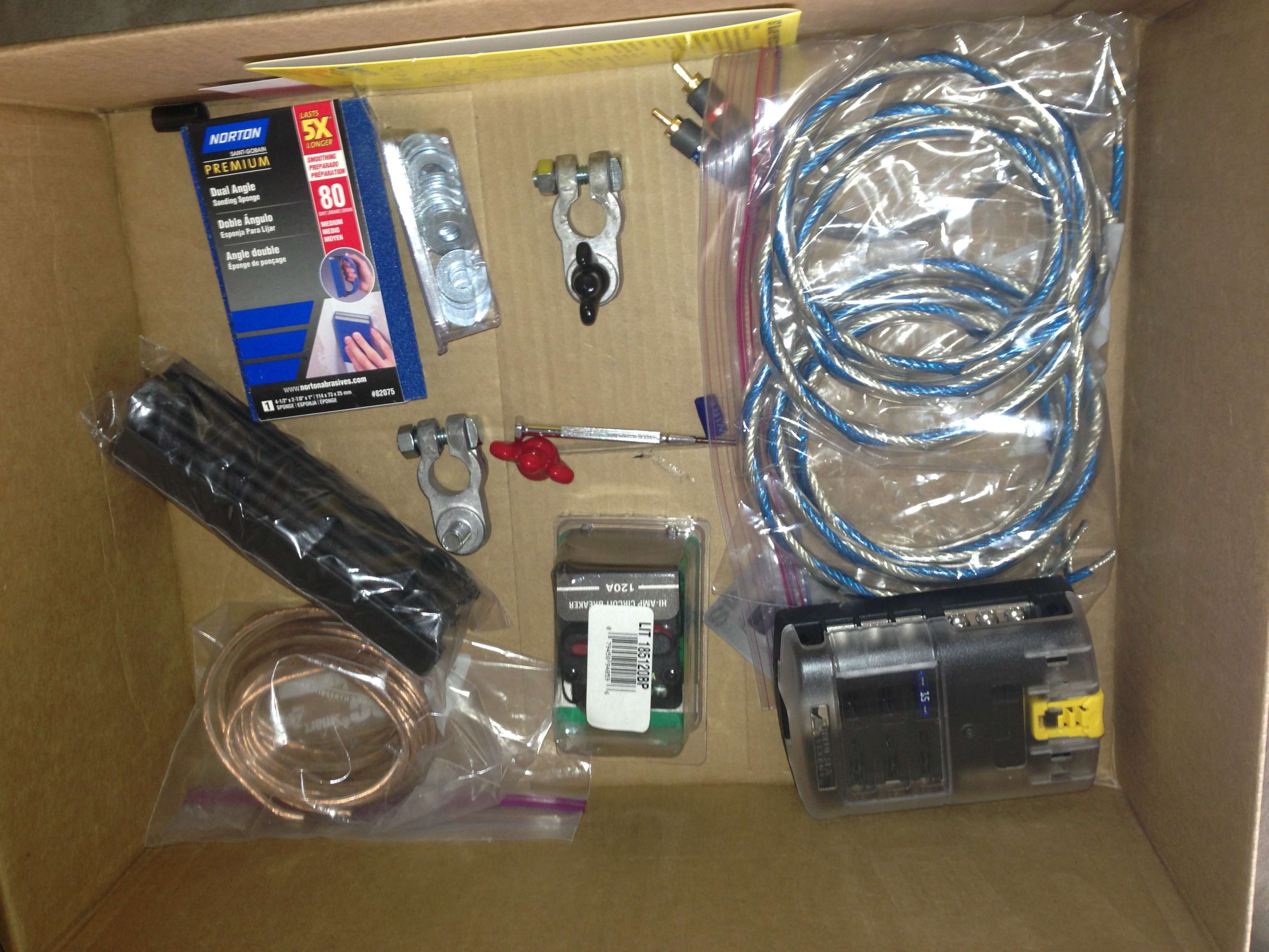

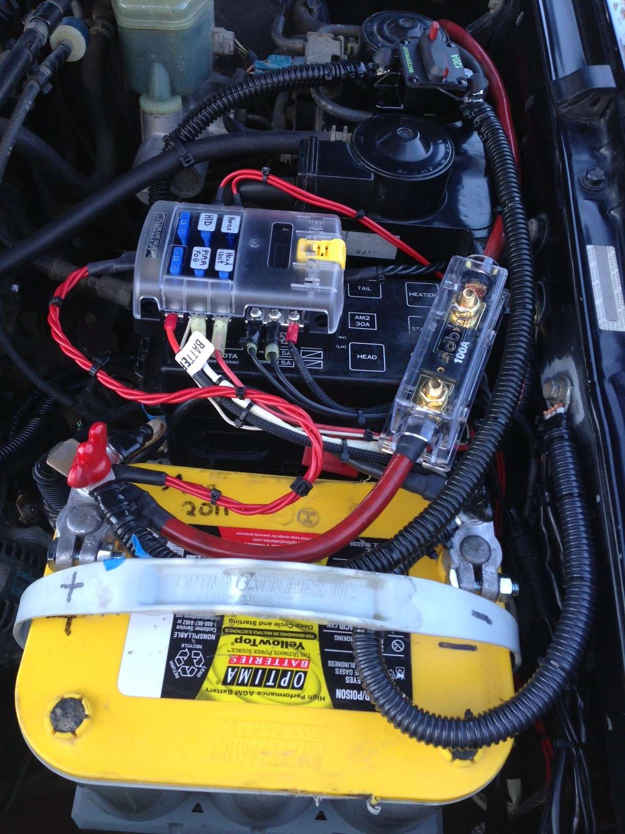

even better go buy new $6 terminals from West Marine and install them. You may have to slightly modify the stock end links to fit onto a 3/8" pole but it will be worth it.
it should look something like this:
