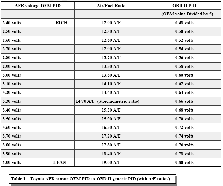

sorry to revive this very old thread but I've got a question that I'm having a hard time finding an answer for.
I have a cali emissions 1999 with the front a/f sensor.
my o2 bank1 sensor1 voltage is always sitting at .6 or .7 volts
The A/F sensor range is 2.8-3.8v
this sounds like my sensor is not working/is faulty. It is supposedly a Denso 234-9002 but i was being a dodo and ordered it from amazon.
it had 4.7 stars with 700+ reviews so I thought maybe it was gonna be good
I just wanna make sure it's not just me not knowing how to read/interpret torque pro's data. i dont get any other readings from any of the "air fuel ratio" sensors so im assuming o2b1s1 is the correct one to see my a/f sensor reading
You are interpreting the data wrong. The standard "O2 Sensor" PID is translated to an 'standard' O2 sensor voltage that would match the output levels of a standard O2 sensor. There are alternate PID(s) that will report actual AFR with the right math.

No, your AFR sensor is working correctly. Some PIDs report on a 0-5v scale, and some report on 0-1v scale. This chart my help.
