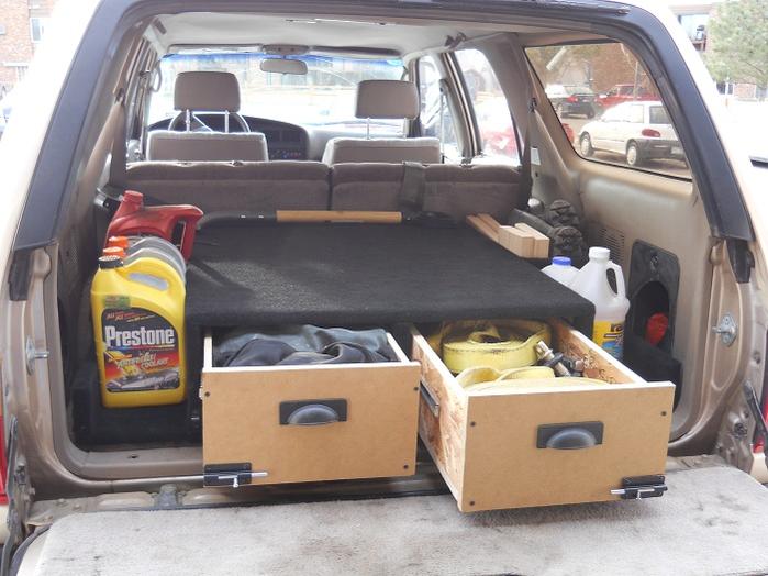

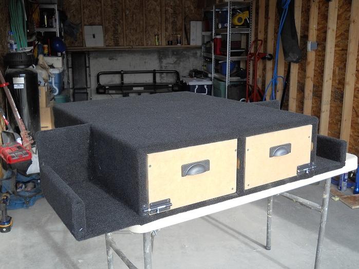

Here's something I built for mine--maybe you could do a second tier, since you want to go a bit higher, maybe like four drawers about this size or one large one below and two of these above? You can always put slides on top of the box, too, to slide stuff toward the back when you want it. I've been thinking of doing a rack of some sort on the sides, just inside the windows, to hang stuff like shovels, Hi-lift, etc., lengthwise--the side windows could be blacked out to keep out wandering eyes (it doesn't matter once you're behind the front seats). Anyway, just some ideas.
