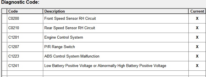

ABS error , the right front and rear sensor on the wheel show zero in Techstream when I drive
here is the snap shot of data from techstream below

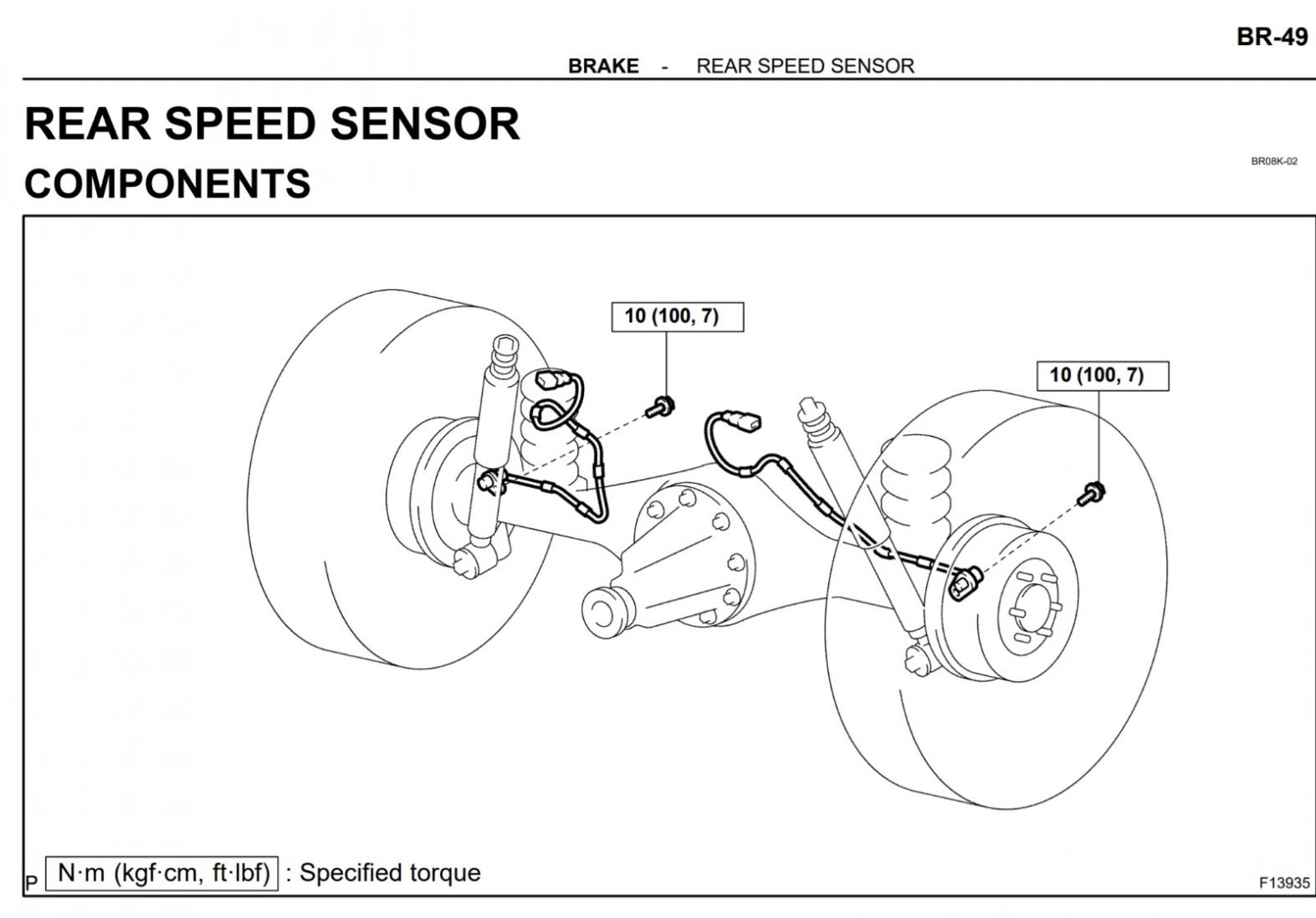

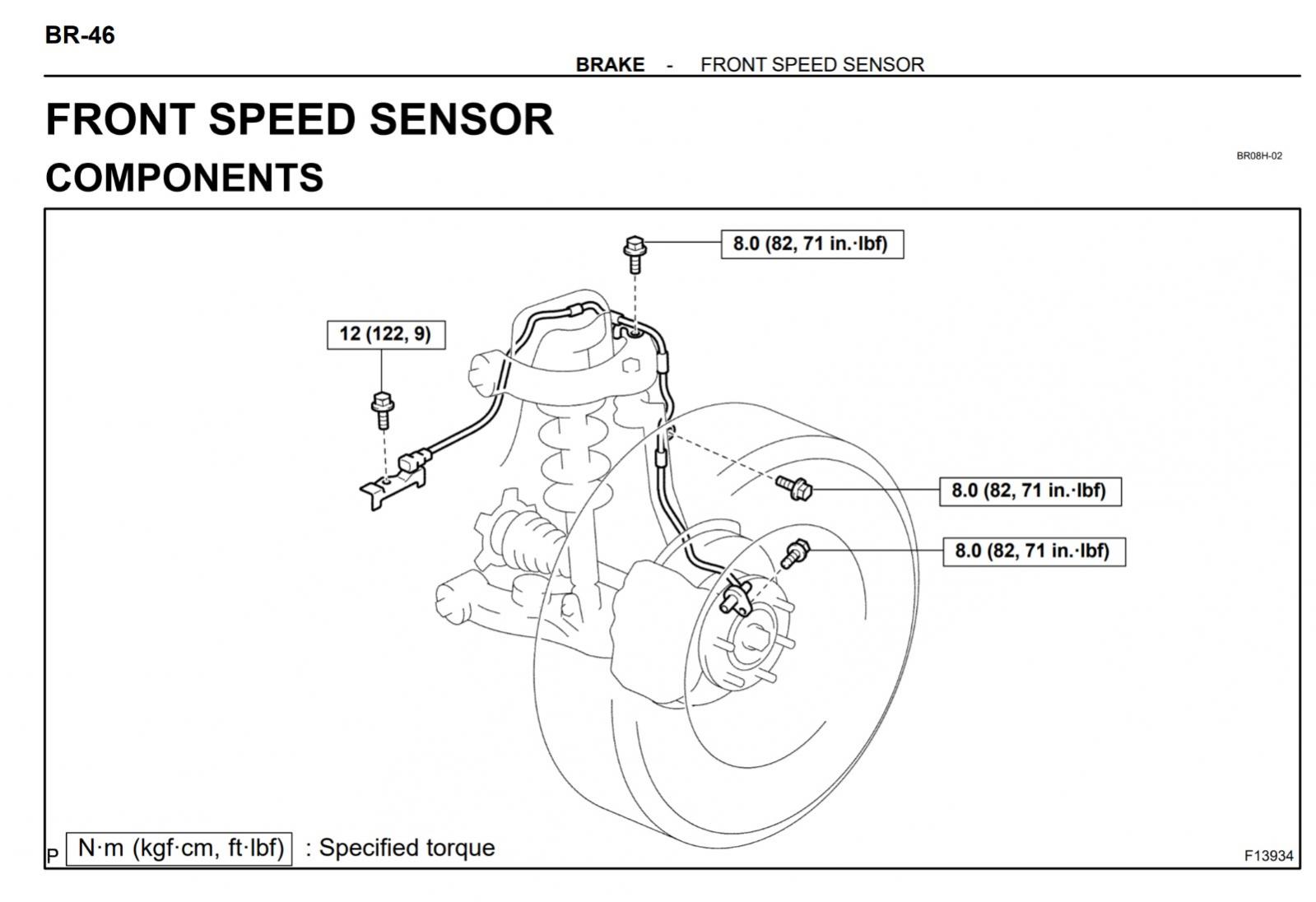

found them both shipped from aliexpress for under 40$ the question is how involved is replacing them?
could it be just dirty? how do you clean them? the problem came about after changing tires .. so the tire shop did something I have to check but a quick pick I don't see any major issues
is it normal for these 2 sensors to read zero?

The wheel speed sensors are pretty easy to replace. 1 bolt holds each of them in then take a pair of slip joint pliers and twist/pull the sensors out. When you take the rear wheel speed sensor out spin the wheel if you can and look at the tone ring. If there is any oil on the tone ring then it's time to do rear axle seals and possibly rear wheel bearings.

The rear wheel speed sensor can be done with the vehicle on the ground.
I'm not entirely sure about the front wheel speed sensor. You may need to remove the wheel and possibly the rotor to get to the wheel speed sensor bolt and clearance to pull it out.
Any update on this? not finding any videos or success stories on the rear sensors. TRQ on YouTube has a video on the fronts.
