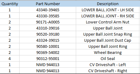

I am gearing up to do a front end rebuild and looking for some last minute advice if anyone has any. I am planning on pulling the spindles and doing new LBJ's, UBJ's, Wheel Bearings, and Front Axles.
I'm at 207k miles and just decided I want to keep it for another 200k miles rather than drop money on a new one. Exclusions to my front end rebuild will include Inner and Outer tie rods because they were just done a few weeks ago. And coils/struts because they are newish 5100s with 99 talls.
Please take a look at parts list below and comment if you think I should add any accessory items. For example I know I will be getting 8 new LBJ bolts because I am sure some will break.
Might want to do control arm bushings while you have it all torn apart.
This may sound lazy but I don't feel like dealing with that headache. I know my LCA adjusters are seized but the caster is fine. If there is noticeable play in the control arm when I have everything out I will rethink this. But I know that job can be a nightmare.
On the UBJ, the snap ring and dust cap come with the OEM UBJ. That "ring" is just a wire and is included as well. Also the grease, nut, and cotter pin.
The castle nut is also included with the OEM LBJs. Do get new bolts and use LocTite.
Good to know. I'm putting all this in a list because I want to order everything that is needed or may be needed once and be done with it.
