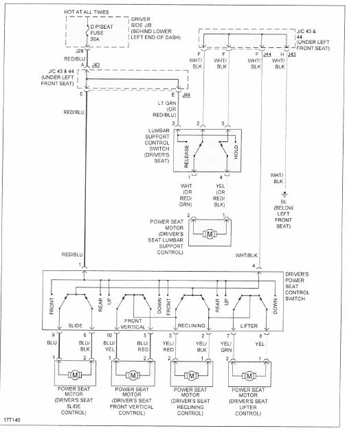

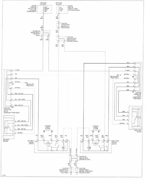

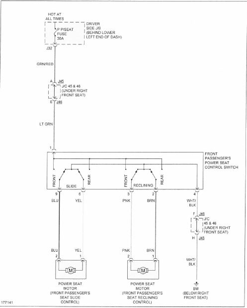

2003 Toyota 4Runner Diagram.

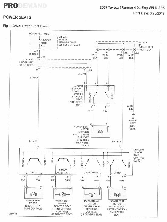

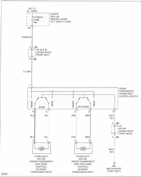

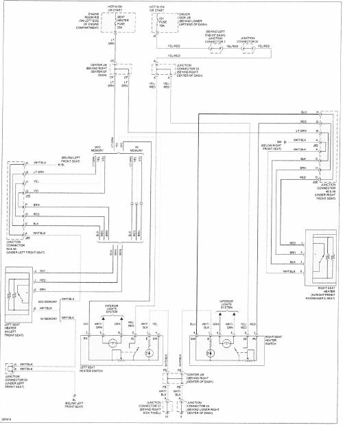

2009 Toyota 4Runner Diagram.
