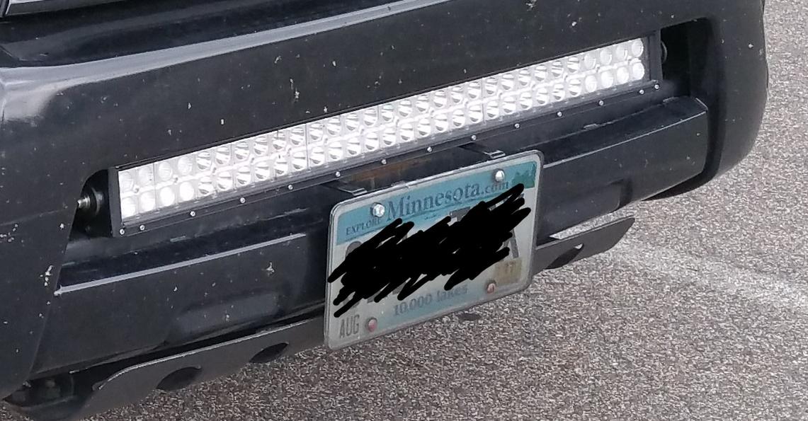

License Plate Relocation
Bought the same brackets from a different vendor so I could get the hood scoop mount too but for those of you concerned about the license plate, relocating is easy and worth DIY. two dimensions (up and out), single strip of steel (~$10) bent up with a vise and some holes. I used the factory holes in the hollow crossmember to feed bolts out of.
you could also use some oversized self-tapping fasteners if you wanted to work outside-in. I had to use a crossbar in front since the hole spacing on the plate was just inside that of the factory spots. Also all the info and write ups I have seen mention cutting the plastic grill. This is NOT necessary as you should be able to flex it out from behind the bumper in one piece and save for potential use later on.

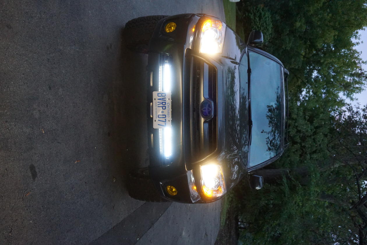

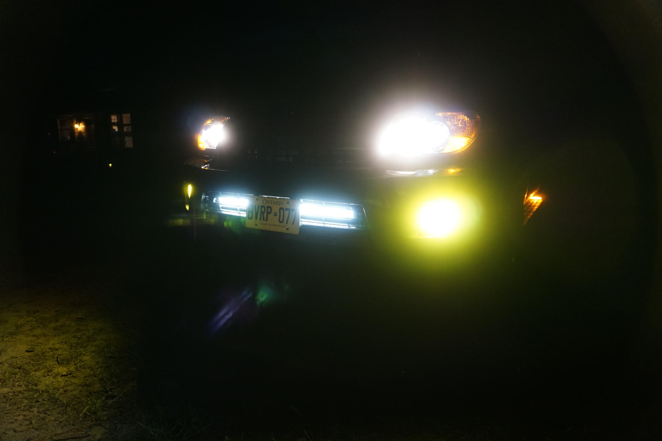

Got mine on. Fit and finish of the brackets was bang on. I chose to leave my lower grill insert on and still got it to work. I shaved some off the back of it and jammed it in there.
Hardest part for me was connecting the light to it. Nothing wrong with the brackets however, it was the light I bought and the mounting hardware it came with. Again, I made it work though and added my own bolts on each end of the light.
Will try to get some shots of it without lights on and closer up.

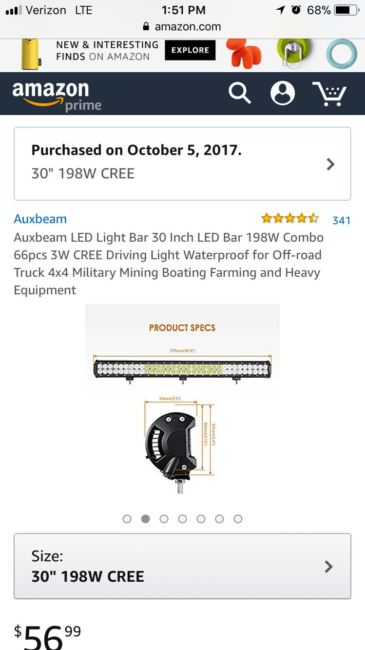

Is there a flush or stealth mount bracket for 30" auxbeam led bars with the 3 mounting bolts along the bottom side of the bar and not on the end caps?
