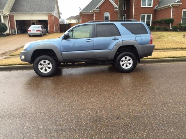

I installed the OME885 on Bilstein adj. shocks set on lowest setting today on my sons 03 2wd v8. Should have gotten 2.5"-3", I ended up with over 4". Not complaining, just trying to figure out how i got so much lift on the front end. Have driven it on some rough dirt roads to settle it in, rides great. Before measurements were driver front 32 3/4", pass. front 32 7/8". Rear setting was driver 35 3/4", pass. 36 1/8". Suspension stock before install on front . Any ideas? Any ideas on leveling back with front?

This was my front right after the lift before driving it around.

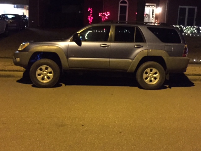

This was after it settled.

I easily lost a 1/2", probably close to 1" after it settled. In the first picture you can see how even the front/rear are, in the second picture you can tell the front is lower. I was actually nose high originally, now it's even.

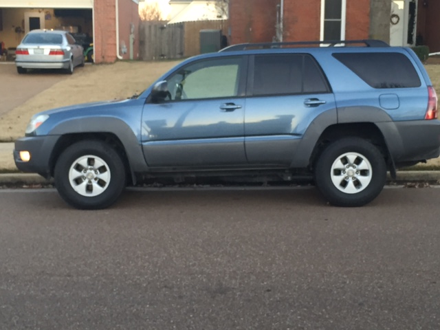

Finally got the rear lifted. when i started the Old Man Emu site said for the v8 go with 2885 which we did along with bilstein 5100 adjustable shocks up front and pro comp 9000's with 2895 rear. .Lift looks good and the ride is good, good and slightly stiff. My son's runner is a 2wd v8, so in hindsight we should have gone 2884 and 2895e in the rear. He's 19 so he wont notice the stiff ride. Rear is right at 38 1/2 " rear and front 37 1/2" front. we do get a slight axle bounce or wrap on backing up, not sure if that will work itself out with settling or not.
