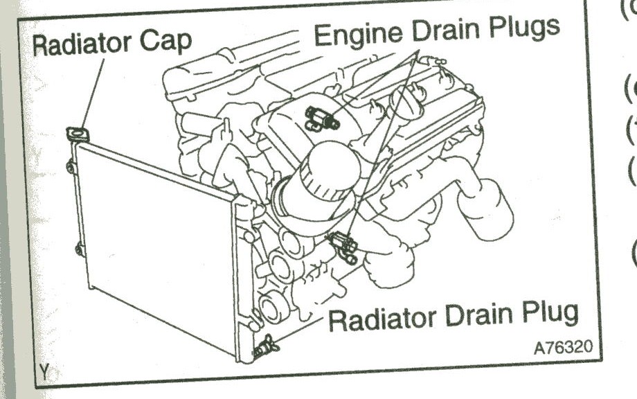

2003 4.0L V-6 coolant drains on block?
kimboy said:
Can somone instruct me on the proper way to collect coolant as it drains on from the rad/block.
Is coolant or antifreeze an oil based product? I've always thought of it as radio active green stuff. (in general)
Can I collect it in a oil catch can, or should I use a large bucket.
I'll bring used coolant back to a garage for proper disposal, but just wanted any insight you guys can give.
You will probably want to use a tub or bucket. Avoid contaminating your oil catch can, since motor oil is recycled. In my area they will not accept oil that has anti-freeze/coolant, brake fluid or another fluids mixed in it.
